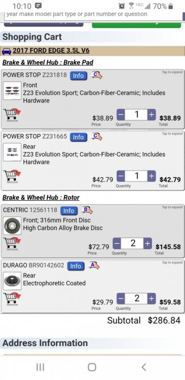

lildisco Posted September 24, 2019 Report Share Posted September 24, 2019 (edited) RockAuto.com usually has a coupon available if you do a Google search. Edited September 24, 2019 by lildisco 1 Quote Link to comment Share on other sites More sharing options...
ThugFordEdge3.5 Posted September 24, 2019 Author Report Share Posted September 24, 2019 5 minutes ago, lildisco said: RockAuto.com usually has a coupon available if you do a Google search. Nice, thank you. Found them. Placed order. Soon as I get them I'll be installing them. We get snow end of October and I'll be doing this outside in driveway. I got 4 weeks to get it done lol Quote Link to comment Share on other sites More sharing options...
lildisco Posted September 24, 2019 Report Share Posted September 24, 2019 Accidentally put the wrong rotors in the cart in the 1 image, but it adds about $200 to the cost if you went with Centrics in the rear. Quote Link to comment Share on other sites More sharing options...
