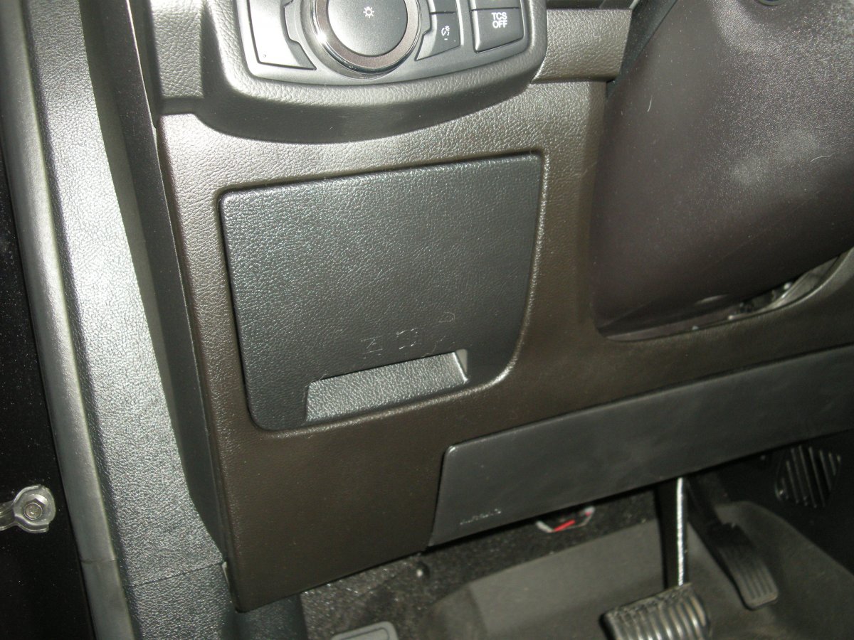

2FAST4U Posted September 7, 2019 Report Share Posted September 7, 2019 In my '16 Titanium, there was a little "drawer" to the left of the steering column in which you could store small items but in my new '19, the door is still there (see picture below) but it won't open and there doesn't seem to be any drawer to pull out… There is a door allright but it doesn't seem to be "openable" even if I pull on it. I don't want to pull too hard and risk breaking it off… but my main question is this: Does someone know what's behind this non-removeable door? Claude. Quote Link to comment Share on other sites More sharing options...
omar302 Posted September 8, 2019 Report Share Posted September 8, 2019 It is supposed to give access to the fuse panel, but like the 2015+ models, fuse access from there is very limited. I also remember reading a member here who got a drawer from a previous model and installed instead of this cover. Just couldn't find that post. I think it was 2018 when they replaced the drawer with the cover. Quote Link to comment Share on other sites More sharing options...

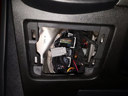

Gadgetjq Posted September 8, 2019 Report Share Posted September 8, 2019 27 minutes ago, 2FAST4U said: Yeah but will the drawer still fit in there?…especially with that fuse panel? It's hard to imagine Ford redesigning the wiring harness to move the fuse box but stranger things have happened I guess. The photo below shows what's inside the opening with my drawer removed. Compare it to later models with the cover to determine whether changes have been made Keep in mind the drawer slopes down when it's closed, it isn't aimed straight back. Quote Link to comment Share on other sites More sharing options...

Gadgetjq Posted October 30, 2019 Report Share Posted October 30, 2019 1 hour ago, 2FAST4U said: won't the drawer interfere with all the stuff that's already in there? Pull your access door and take a look. The drawer was included for 2015 through 2017 and possibly 2018 so, unless something was added back there interference won't be an issue. If you see a wire or harness give it a little push to see if it can be moved out of the way. Quote Link to comment Share on other sites More sharing options...
2FAST4U Posted October 31, 2019 Author Report Share Posted October 31, 2019 3 hours ago, Gadgetjq said: …"unless something was added back there interference" Yeah, that's what I was thinking about… I had the drawer in my '16…but I don't know if the components in my '19 will be in the way of the drawer or not... Claude. Quote Link to comment Share on other sites More sharing options...

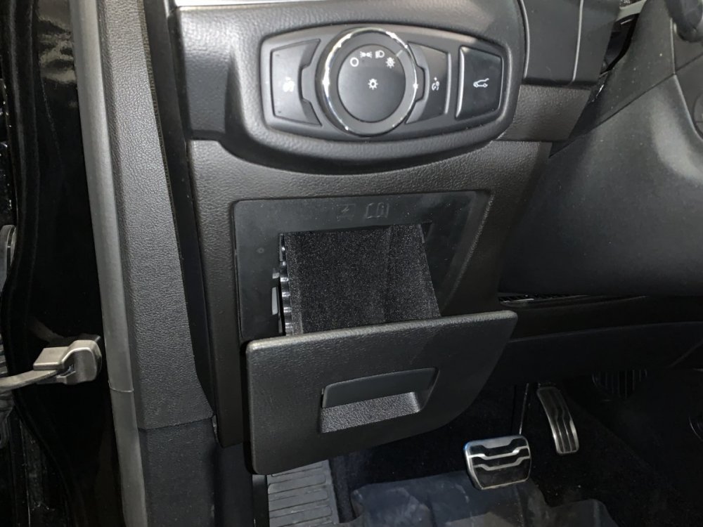

Gadgetjq Posted May 30, 2020 Report Share Posted May 30, 2020 42 minutes ago, Skatematt said: Where did you get this bin? I would like to make this empty space useful. I'd try local auto salvage first (looking for a '15-'18 Edge) and if that doesn't work out hit the online vendors like https://www.car-part.com/ As already discussed the drawer looks like the photo (below) and just snaps right into the area your panel occupies. Use a coin holder (also discussed earlier with links) to hold your small change. Quote Link to comment Share on other sites More sharing options...
2FAST4U Posted June 15, 2020 Author Report Share Posted June 15, 2020 Well I finally swapped my useless "fuse box door" for a drawer from a 2015 -'18. In one of my previous posts, I explained that I was concerned that the drawer might interfere with some components behind the dash but no, it did fit perfectly . Claude. 3 1 Quote Link to comment Share on other sites More sharing options...
