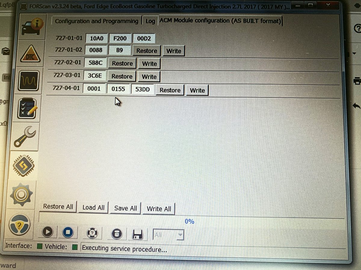

1004ron Posted September 1, 2019 Report Share Posted September 1, 2019 Quote (ACM 727-01-01 xxxx x0xx xxxx change 1 to 0 where shown). 9=FT present & CS: North American & ANC absent & USB present Wouldn't "9" be correct for my vehicle? Quote Link to comment Share on other sites More sharing options...
Gadgetjq Posted September 1, 2019 Report Share Posted September 1, 2019 29 minutes ago, 1004ron said: 9=FT present & CS: North American & ANC absent & USB present Wouldn't "9" be correct for my vehicle? Think you're right, either 9 or A (ANC Present). Maybe make a choice based on what's already in that x slot. Be sure and note the original setting just in case you don't get the result you expect. 1 Quote Link to comment Share on other sites More sharing options...

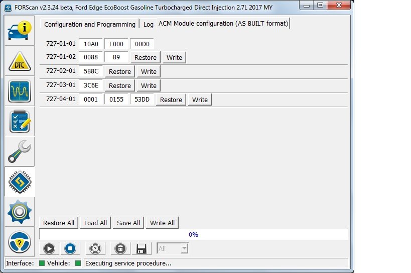

1004ron Posted September 1, 2019 Report Share Posted September 1, 2019 (edited) Looks like the latest Forscan revision displays the values differently. I'll change the "F200" to "F000" and take it for a test drive and report back. Edit: All done and a short test drive confirms that its quieter under hard acceleration, and something else I notice is the distinctly different tone of the parking sensor beeps. If I change the "F200" to "F000" , then automatically the last set changes from "00D2" to "0D00" - not sure what that's about. Edited September 1, 2019 by 1004ron Quote Link to comment Share on other sites More sharing options...

omar302 Posted September 2, 2019 Report Share Posted September 2, 2019 7 hours ago, 1004ron said: If I change the "F200" to "F000" , then automatically the last set changes from "00D2" to "0D00" - not sure what that's about. The last two digits are a checksum, it is normal to change after any change in the digits before. ForScan will calculate the correct checksum for you. 7 hours ago, 1004ron said: and something else I notice is the distinctly different tone of the parking sensor beeps. Normally the vehicle tones are routed through the audio speakers, sometimes they would come directly from the instrument panel cluster. They should return back to the audio speakers after a vehicle restart. If they remain coming from the instrument cluster then you have an issue, either the setting was changed with ForScan or some other reason. 1 Quote Link to comment Share on other sites More sharing options...
