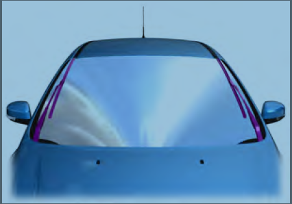

Looks like you have the issue sorted but for future reference the "service position" for wiper blades (handy when washing your Edge) is detailed in your owner's manual (and yes, it certainly could have been explained better).  Here's a copy/paste:
Set the windshield wipers in the service position to change the wiper blades. The windshield wipers return to the starting position when you switch the ignition on.
1. Switch the ignition off.
2. Move the wiper arms to the service position manually.
Note: You cannot move the wiper arms to the service position manually when you
Note: You can use the service position to provide easier access to the wiper blades
for freeing them from snow and ice. Make sure the windshield is free from snow and
ice before you switch the windshield wipers on.
