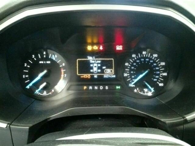

Roadhawk Posted December 11, 2020 Report Share Posted December 11, 2020 This is the cluster I was thinking about. Since its the base model the lens mask should already work, correct? Quote Link to comment Share on other sites More sharing options...
omar302 Posted December 11, 2020 Report Share Posted December 11, 2020 49 minutes ago, Roadhawk said: This is the cluster I was thinking about. Since its the base model the lens mask should already work, correct? I don't see why it wouldn't work. On the 2G Fusion forums several had upgraded from this one to the twin screen one. And as long as your getting the cluster from an Edge of similar model range, the lens that comes with it should also work. The only downside with this screen is the display's resolution will remind your that's it's the "lower level" cluster. 1 Quote Link to comment Share on other sites More sharing options...

Roadhawk Posted December 12, 2020 Report Share Posted December 12, 2020 The base cluster was in the SEL I test drove along with the 4in Sync screen in the center stack. I suppose I should’ve took a few moments to see what the right side control pad on the steering wheel was linked to. loss of the right side screen is all I see being lost and not that crucial IMO. So would downgrading to the base screen require different firmware? Quote Link to comment Share on other sites More sharing options...
