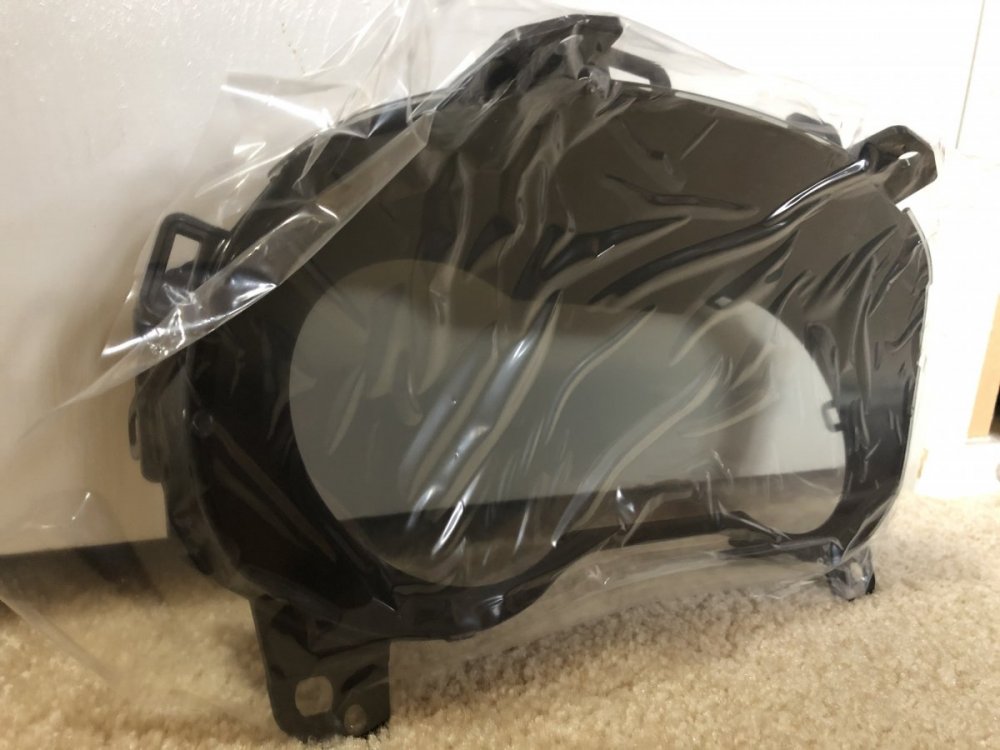

onyxbfly Posted November 1, 2019 Author Report Share Posted November 1, 2019 (edited) On 10/31/2019 at 11:48 PM, zrt8355 said: Nautilus cluster has arrived...but the connector on the back is definitely different than that of the MKX/Edge clusters. If anyone has any ideas I would be interested to hear them. I want to avoid cutting any wires on my Edge, but if I could just take the pins out of the current connector and rearrange them in the new one, I'd be down for that. Would just need access to pinouts for both cars to see if it's all the same wires in a different arrangement or what. Expand Glad to hear that you received your cluster! Things are getting interesting! You're definitely making progress! Drop @TXFRDOwner a line. He makes custom harnesses. Edited November 1, 2019 by onyxbfly Quote Link to comment Share on other sites More sharing options...
zrt8355 Posted November 1, 2019 Report Share Posted November 1, 2019 On 11/1/2019 at 7:00 AM, onyxbfly said: Glad to hear that you received your cluster! Things are getting interesting! You're definitely making progress! Drop @TXFRDOwner a line. He makes custom harnesses. Expand Perfect, I'm already in touch with him since (if this works out) I'll be getting the lens from him. Maybe he can get something figured out. 1 Quote Link to comment Share on other sites More sharing options...
omar302 Posted November 1, 2019 Report Share Posted November 1, 2019 On 11/1/2019 at 12:52 PM, zrt8355 said: Perfect, I'm already in touch with him since (if this works out) I'll be getting the lens from him. Maybe he can get something figured out. Expand Hope it goes well. Keep us updated. I am really bored with stock cluster, been seeing it since 2012 and I hate the useless way the information displays are devided. With the round tacometer you can't get any other vehicle information. 1 Quote Link to comment Share on other sites More sharing options...
zrt8355 Posted November 1, 2019 Report Share Posted November 1, 2019 On 11/1/2019 at 1:47 PM, omar302 said: Hope it goes well. Keep us updated. I am really bored with stock cluster, been seeing it since 2012 and I hate the useless way the information displays are devided. With the round tacometer you can't get any other vehicle information. Expand Will do. TXFRDOwner actually seems to already have a compatible harness made from someone else doing a Continental cluster retrofit in a Fusion. Depending on how much he wants for it I'll gladly give it a shot. He stated that the guy doing that conversion got it to turn on but it has issues with some of the existing steering wheel controls not working on the new cluster due to firmware incompatibility. So that would likely be my case and another project to tackle. If DanMc85 can't get around that himself (he's the one at the Fusion forums doing this and he is a godsend at programming) then I know I won't be able to do it either. We shall see. 2 Quote Link to comment Share on other sites More sharing options...
