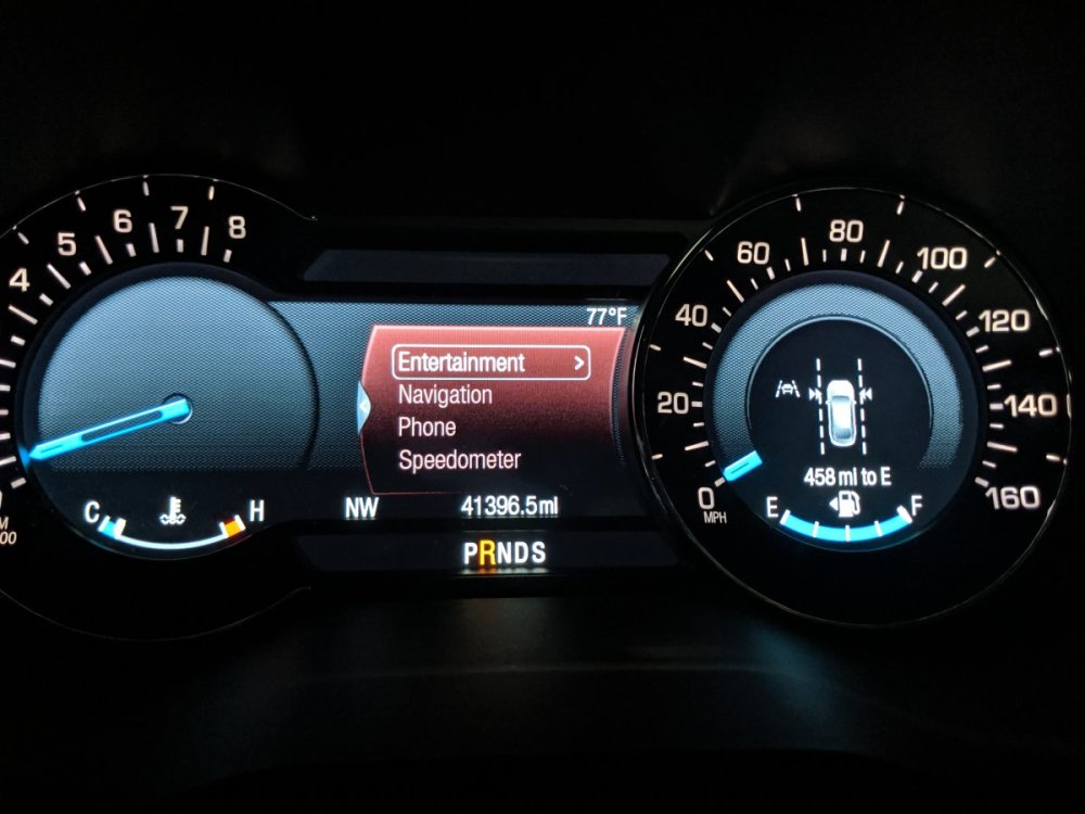

I see some errors ...No redline and whats the little car in the lane by the large graphic showing the same?  I think thats an option not supported on the Edge.  Trying to go from memory.
And 458 till empty...what motor you got? LOL never seen my sport that high.

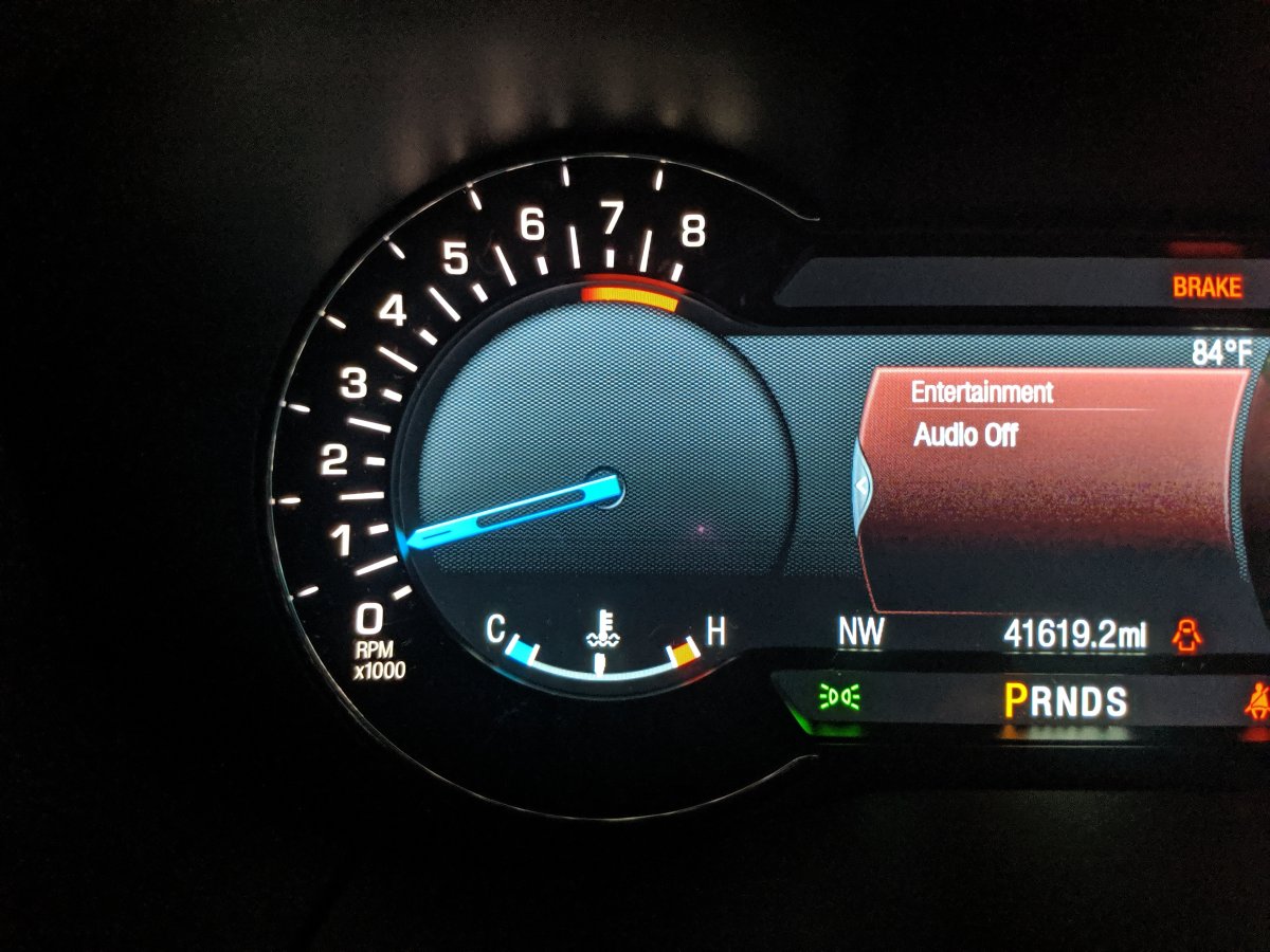

Issue resolved!  If you see any other errors please point them out.
That is a feature enabled in the latest edge firmware.
That pic was the first pic after installing it.  18 gallon gas tank at a theoretical 25-26 miles per gallon, will put you in the 450-468 miles.  I only get in the 400s when, I do tank to tank highway miles rod trips etc.

Glad to see the redline fixed...the option that you say is in the latest Edge firmware....that Icon is for lane centering isn't it.  Had nothing but issues on the interstates with mine when I tried that, 2 lane roads were fine.  If that is what it is, the 17 Edge doesn't have that option.  What firmware is the cluster running?  I finally opted to run 18 MKX to keep it as close to the Edge model as possible.  I had it tweaked back to Ford colors along with adding a pic of my Electric Spice Edge in the middle during startup.

I believe that Dan said that it was the latest firmware. I linked Dan to this thread. He may join and answer any of the behind the scenes questions. My cluster is from an 18MKX I'm not sure what the differences between the firmware and clusters.
