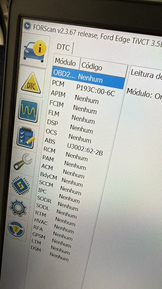

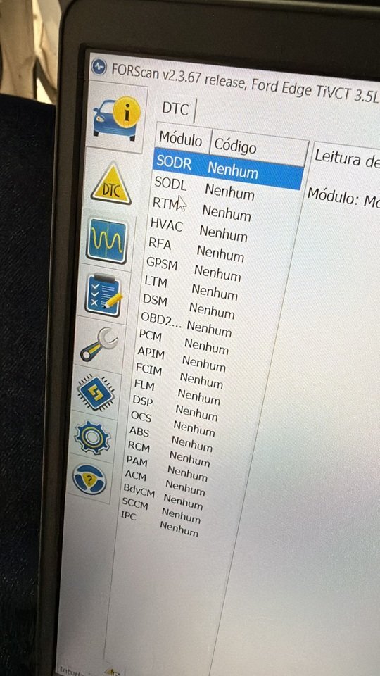

PatrickGuinalia Posted October 9, 2024 Report Share Posted October 9, 2024 Hey guys! Also reactivating the topic, I had the same problem on my Edge AWD 2014 3.5. The car was off, I simply turned it on and the parking brake, ABS, traction control and stability control lights were on, accompanied by two warnings on the left screen of the dashboard: check brake system and advancetrac service. (picture 1) The codes shown on the forscan were P193C and U3000-49. (picture 2) When searching here on the forum and also in various videos on the internet, many people recommend replacing some internal components of the ABS module. However, sometimes this warning does not occur, and no warning light comes on on the dashboard, which appears to be an intermittent error. So I'm still unsure whether to disassemble the part and send it for repair, as it's a very expensive service and I'm afraid it won't be resolved. Yesterday I disabled the AdvaceTrac, ABS and TCS options in forscan, and the error message on the left screen 'check brake system' does not appear. In this case, with these lights deactivated, another code showed on the panel: U0415:56-2F. After researching, he led me to a person who discovered a problem with one of the ABS sensors on the wheels. (picture 3) Now I'm in doubt as to what the reason for the problem would be, because the mechanic recommended replacing the abs module, but I have three codes: P193C and U3000 together, and when these are erased and their indications are turned off in the forscan, U0415 appears. The car's brakes work normally, when traveling or in urban traffic, no problems when using the brake pedal, no strange noises or anything like that, everything is normal with or without the warning lights. Quote Link to comment Share on other sites More sharing options...
dabangsta Posted October 9, 2024 Report Share Posted October 9, 2024 I would spend the time to look at all the ABS sensors and wiring, and since you can data log, show each wheels ABS speed and see if one isn't correct to help determine which one it might be. Hopefully someone can post the error code breakdown for the :56 part and what status of 2F is to help. If the ABS module is getting incorrect data it might be causing it to also set a code, I know it says it is an internal fault but if an ABS sensor is grounding (in some cases the wires are too short or too long and wear on suspension parts, in the rear I think) might cause it. Quote Link to comment Share on other sites More sharing options...
PatrickGuinalia Posted October 9, 2024 Report Share Posted October 9, 2024 9 hours ago, dabangsta said: I would spend the time to look at all the ABS sensors and wiring, and since you can data log, show each wheels ABS speed and see if one isn't correct to help determine which one it might be. Hopefully someone can post the error code breakdown for the :56 part and what status of 2F is to help. If the ABS module is getting incorrect data it might be causing it to also set a code, I know it says it is an internal fault but if an ABS sensor is grounding (in some cases the wires are too short or too long and wear on suspension parts, in the rear I think) might cause it. Hello friend! I tested all the ABS wheel speed sensors and they are correct, no sudden changes even with the warning lights on. Test: The code U0415 seems to only appear when I disable ABS, traction type and traction control in the FORScan. If I enable the options normally, it disappears and only P193C and U3000-49 remain. Maybe U0415 it's just a warning of incorrect panel configuration. Is there a test for the steering angle sensor, before definitively condemning the ABS module for repair? Quote Link to comment Share on other sites More sharing options...
