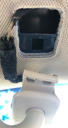

crazywater Posted July 30, 2019 Report Share Posted July 30, 2019 (edited) I have a replacement sunvisor for the passenger side and I am trying to figure out how it get connected to the ceiling. I have connected the wiring but can't seem to figure out how to snap it in. Or am I missing a clip of some kind? Any help is appreciated. Edited July 30, 2019 by crazywater Added pictures 1 Quote Link to comment Share on other sites More sharing options...
crazywater Posted July 30, 2019 Author Report Share Posted July 30, 2019 Got my answer. Need clip part #9941032 which I just ordered. 1 Quote Link to comment Share on other sites More sharing options...
mvan231 Posted July 30, 2019 Report Share Posted July 30, 2019 I believe there are just plastic clips that hold those in place. I'ts not the best solution though Quote Link to comment Share on other sites More sharing options...

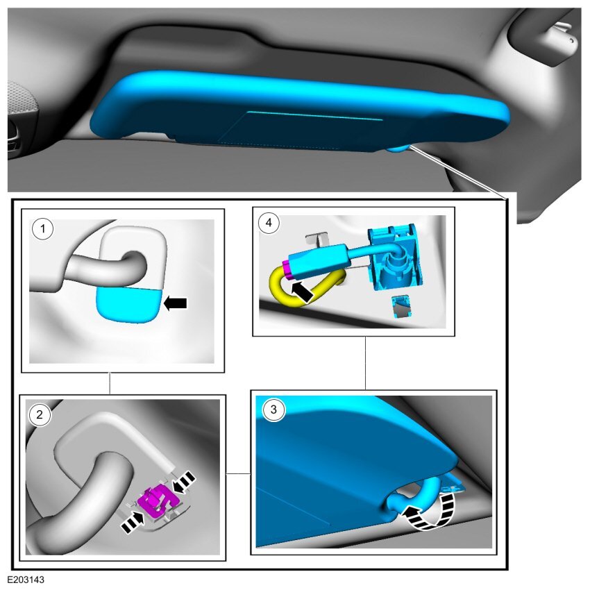

Dougbobo Posted May 19, 2024 Report Share Posted May 19, 2024 On 7/30/2019 at 7:24 AM, crazywater said: Got my answer. Need clip part #9941032 which I just ordered. How do the clips go in?? I can’t find this instruction anywhere… Quote Link to comment Share on other sites More sharing options...
Haz Posted May 19, 2024 Report Share Posted May 19, 2024 Welcome to the Forum, @Dougbobo! From the 2018 Edge Workshop Manual... Remove Sun Visor Remove the sun visor retainer cover. Remove the sun visor retainer. Remove the sun visor. If equipped. Disconnect the sun visor electrical connector. Good luck! 3 1 Quote Link to comment Share on other sites More sharing options...
Dougbobo Posted May 19, 2024 Report Share Posted May 19, 2024 5 hours ago, Haz said: Welcome to the Forum, @Dougbobo! From the 2018 Edge Workshop Manual... Remove Sun Visor Remove the sun visor retainer cover. Remove the sun visor retainer. Remove the sun visor. If equipped. Disconnect the sun visor electrical connector. Good luck! Thank you! That’s exactly what I needed to see 👍🏼👍🏼 1 Quote Link to comment Share on other sites More sharing options...
