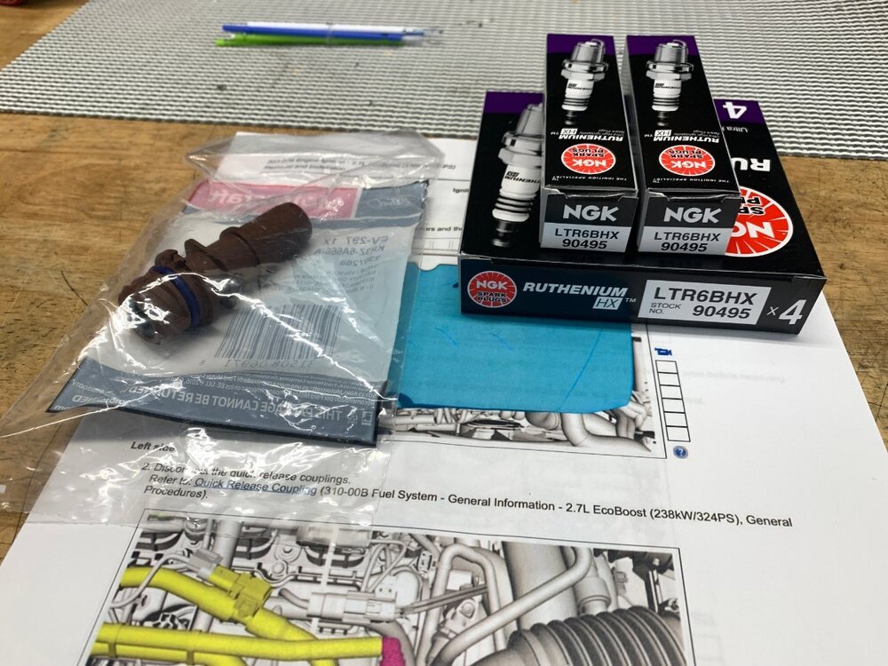

1004ron Posted October 26, 2024 Report Share Posted October 26, 2024 Installed the new NGK's this morning. The old plugs looked very good and no change in gap - just thought that there may be benefits with the revised heat range plugs. Looked into the cylinders and they're all pristine, like brand new. 2 Quote Link to comment Share on other sites More sharing options...
