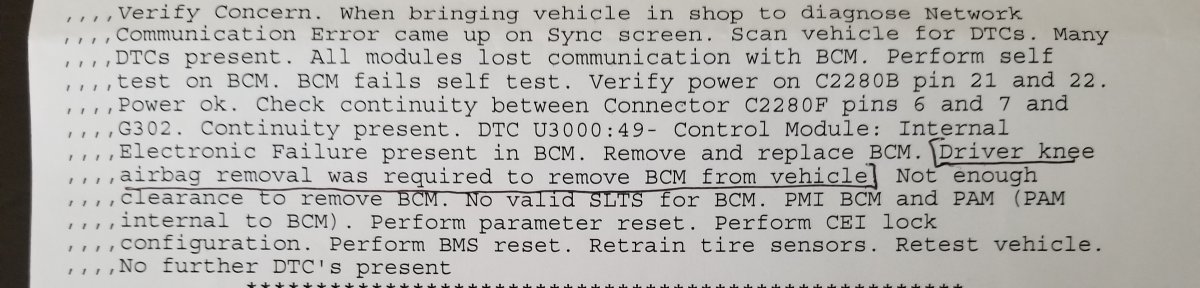

ONEDGE16 Posted July 27, 2019 Report Share Posted July 27, 2019 (edited) Took the car in to the dealership yesterday to get the Adaptive Headlamps recall done, at the same time asked them to look at the climate seats for a couple of issues: 1- with remote start, only driver seats come on (heat/cool) on 2- only the bottom part of the seat function, the back lumbar area not cooling/heating 3- when cool is on, the seat fan is loud enough to hear it with the radio on Gets a call in the afternoon to let me know that they need to replace BCM. Here's what the tech put on the work order Edited July 27, 2019 by ONEDGE16 . Quote Link to comment Share on other sites More sharing options...

ONEDGE16 Posted July 27, 2019 Author Report Share Posted July 27, 2019 (edited) 50 minutes ago, Sage said: On your BCM replacement, did that correct your seat back not cooling/heat? I have the same issue and my Ford dealer has know idea why and has a call into a Ford engineer. It only fixed the remote start issue. Not the back lumbar section of the seats heating/cooling and cooling fan too loud. They still have to fix that one. There is SSM 47814 out there but doesn't seem to address it either. February 19, 2019 MANUFACTURER COMMUNICATION NUMBER: SSM 47814 Components: ELECTRICAL SYSTEM, SEATS NHTSA ID Number: 10156883 Manufacturer Communication Number: SSM 47814 Summary Some 2016-2019 Explorer, 2016-2018 MKX, 2019 Edge/Nautilus, 2017-2019 Fusion/MKZ, and 2018-2019 F-150/Mustang/Expedition/Navigator vehicles equipped with climate controlled seats may exhibit a buzzing noise from the front seats, front seats too warm, and/or inoperative climate controlled front seats. DTCs B14BA:13, B1154:4B, and/or B14B9:13 may also be present. This may be due to loose terminal pin fit on the driver seat module (DSM) connector C341D (16 pin). If a loose terminal pin fit condition is found during normal diagnostics per Workshop Manual (WSM), Section 501-10, a new service pigtail connector (part number 3U2Z-14S411-BRAB) is available. Refer to Wiring Diagram, Cell 119 to make sure C341D is a 16 pin connector and not a 20 pin connector. Refer to Wiring Diagram, Cell 5 for the recommended splicing procedures. Edited July 27, 2019 by ONEDGE16 added SSM info 1 Quote Link to comment Share on other sites More sharing options...
