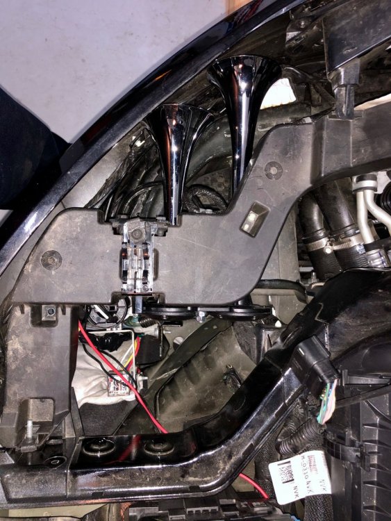

poontanghooligan Posted October 31, 2020 Report Share Posted October 31, 2020 Old topic but I replaced the "Prius" horn on my 2020 ST with a set of air horns from Amazon: https://amzn.to/34KaVXp. Only $35 for the kit. Took about an hour taking my time. Hardest part was figuring out where to mount the horns. Found an existing hole on the plastic cross brace below the headlight. Was like it was meant for it. I used the factory horn mount to mount the new relay and a simple L-bracket to mount the pump. Horns sound amazing and scare the $hit out of errant lane changers. 2 Quote Link to comment Share on other sites More sharing options...
txaggie Posted January 23, 2021 Report Share Posted January 23, 2021 Holy cow!! I'll bet you get the offender's attention with that setup!! Quote Link to comment Share on other sites More sharing options...
