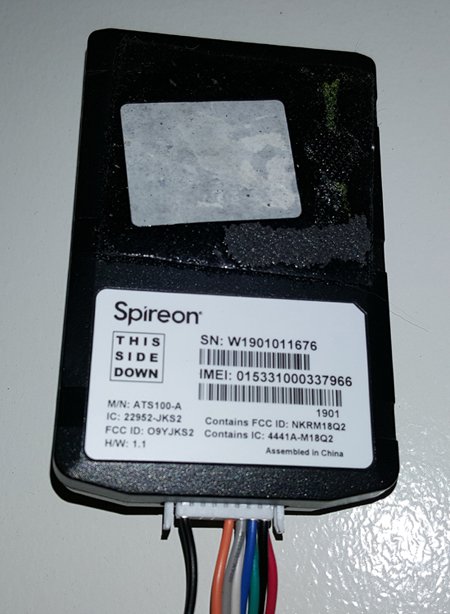

Gadgetjq Posted June 27, 2019 Report Share Posted June 27, 2019 2 hours ago, urbanrules86 said: We bought it new, I believe we have anti theft since we have a flashing blue light under the steering wheel. Could it be something with that? It's probably the device shown in the photo (below). As AK suggested it's a dealer installed tracking device. It's initially for their protection in case someone absconds with the vehicle from their lot (or during a test drive). Dealers typically try to charge the buyer several hundred dollars for it during the sale negotiation. If you refuse it they don't usually bother to remove it. Here's the thing. Before you rip it out by the roots (unless you opted to pay for it), consider taking advantage of the power and ground connections it offers. The trackers are usually attached to the harness someplace under the dash offering you a nice unswitched source at some point in the future. So, look under the dash, pull out the device then 'carefully snip the wires or just pull the plug on the box. Tape the + wire to prevent any chance of shorting out. Quote Link to comment Share on other sites More sharing options...
