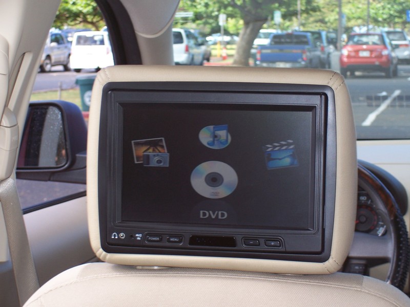

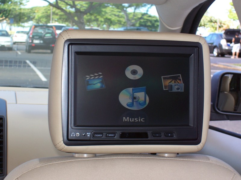

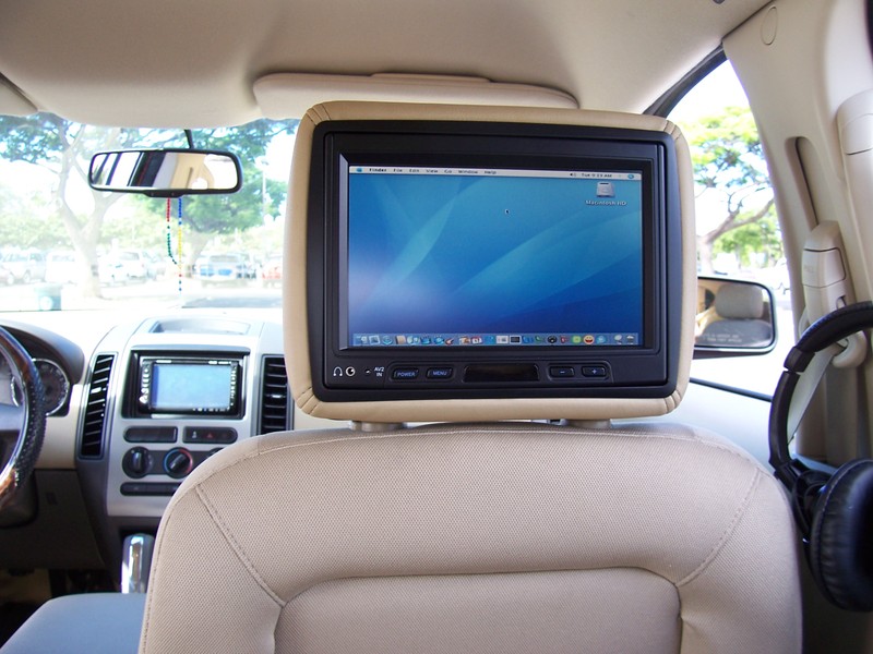

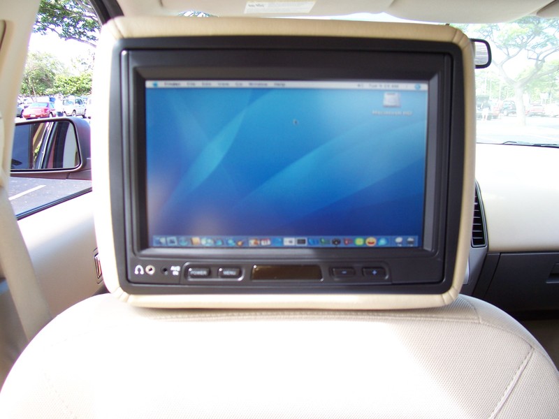

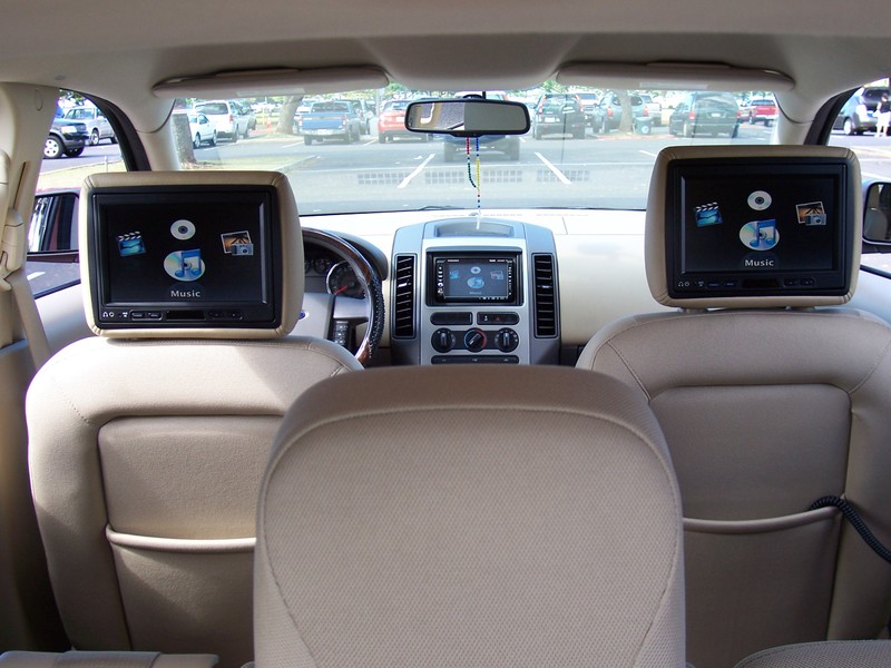

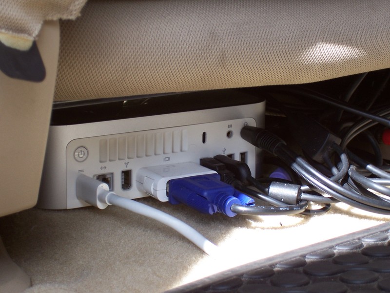

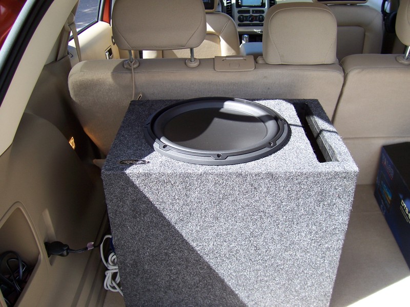

xtremedge808 Posted July 15, 2008 Report Share Posted July 15, 2008 (edited) table of contents: interior 8 diamond component tweeters 4 boston SL speakers.. double din dts 660w head unit ipod/ 6 channel output/ reverse camera / 25x5 mofset pre amp/ and ect. jl 12" w6v2 with alpine 800 watts amp kenwood kac- 8403..60x4 rms 4/3/2 watts amp. 180 watts rms in 2 channel. and 800 watts peak in mono channel. bridgeable dual head rest monitor 10.5" LCD made by concept directed sst 1 mile range python pager, remote start, alarm system apple mac mini with core 2 duo 350 watts power inveter from radio shack pc to tv converter gigaware from radio shack exterior 6000 k hid lights 20 inch zinik violi rims nitto 420 tires 2.5" cat back pipe with flow master super 40 sounds deeper now pictures Edited July 15, 2008 by xtremedge808 Quote Link to comment Share on other sites More sharing options...
Lex Talionis Posted July 15, 2008 Report Share Posted July 15, 2008 okay.. I am a huge Mac fan, been using for +20 years.. so I am interested in exactly what you can do with that Mini hooked up? please expand on that mod a bit more would ya. no doubt you have some extreme mods there, pretty tricky and techie Quote Link to comment Share on other sites More sharing options...
xtremedge808 Posted July 16, 2008 Author Report Share Posted July 16, 2008 okay.. I am a huge Mac fan, been using for +20 years.. so I am interested in exactly what you can do with that Mini hooked up? please expand on that mod a bit more would ya. no doubt you have some extreme mods there, pretty tricky and techie benefits: 1. you can use front row by the remote..you can view itunes,picture, dvd, video 2. go to the internet >>>> requires a wireless modem like HTC PC phones , sprint air card, or clearwire 3. edit your office work last minute in the car using power point, word, excel and ect. 4. you can chat using your ichat, yahoo messenger, and msn 5. your can easily access your email using your imail tools you need go radioshack.com 1. a mac mini >>> 100 watts consumption 2.Double Din head unit with aux video, aux sound input 3..pc to tv converter: gigaware converter http://www.radioshack.com/product/index.js...rentPage=search 4.power inverter http://www.radioshack.com/product/index.js...rentPage=search 5. y- cable for audio and a long video cable 3.5mm jack to left and right channel rca"red and white plug" just regular yellow coded plug for video Quote Link to comment Share on other sites More sharing options...

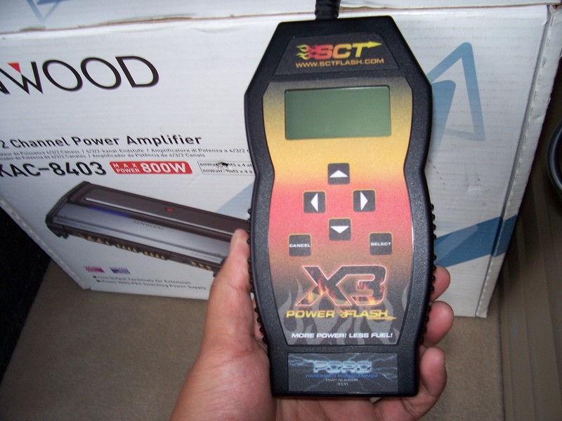

kdd01 Posted July 16, 2008 Report Share Posted July 16, 2008 Nice, Xcal3. Who did the tune ? Should have received mine via fedx today - Evolution performance. They are only 45 minutes from me but it was not much to just get it shipped. Quote Link to comment Share on other sites More sharing options...

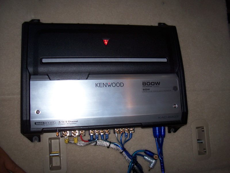

cbEdge Posted July 29, 2008 Report Share Posted July 29, 2008 (edited) Hi xtreme, Where did you mount that amplifier? is that the floor underneath the backseat? I had my stock speakers replaced with Kicker KS680's and now I'm looking for an amp that will fit under the rear seats without being crushed whenever they are in a flattened position. The installer looked under the seats when they were in this position, and noticed how the seat bottoms shift downward almost flush to the floor. He was afraid to put anything under there. He suggested I look for the smallest amp I could find (memphis, pioneer). Edited July 29, 2008 by cbEdge Quote Link to comment Share on other sites More sharing options...
xtremedge808 Posted July 29, 2008 Author Report Share Posted July 29, 2008 (edited) Hi xtreme, Where did you mount that amplifier? is that the floor underneath the backseat? I had my stock speakers replaced with Kicker KS680's and now I'm looking for an amp that will fit under the rear seats without being crushed whenever they are in a flattened position. The installer looked under the seats when they were in this position, and noticed how the seat bottoms shift downward almost flush to the floor. He was afraid to put anything under there. He suggested I look for the smallest amp I could find (memphis, pioneer). the one you saw in the picture is my first try to install that 4 channel amp. i just drilled that amp in the back of the seat =] i drilled the mono amp in the back of my subwoofer box and the 4 channel amp in the spare tire compartment =] ps if u wanna put the 4 channel amp in the spare tire compartment...you will need to buy 4 radio shack ball bearing cooling fans for good air ciculation [fan[fan|amp|fan]fan]air goes this way ====>..i already tried it at 98F at 12:00 noon in a open parking lot and i never found any overheating issues. subwoofer is kinda critical in this temperature range so dont go over 55 db rms. subwoofer is very sensitive to heat =[ Edited July 29, 2008 by xtremedge808 Quote Link to comment Share on other sites More sharing options...
cbEdge Posted July 30, 2008 Report Share Posted July 30, 2008 Where did you install the amp in the tire compartment? We took a look under there and saw very little room. Would you mind snapping a few pics of the compartment? I would love to be able to fit the amp in there. Thanks! Quote Link to comment Share on other sites More sharing options...
