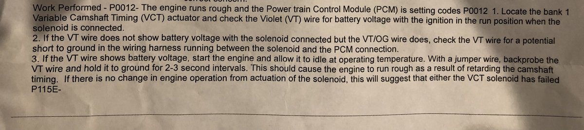

Angstu Posted May 22, 2019 Author Report Share Posted May 22, 2019 Thank you so much for the insight. The rattling has only been happening for a few days. I took a snapshot of the issues the mechanic noted in the invoice. Any chance you can take a look and see f that matches what you were thinking? I really appreciate your time! Quote Link to comment Share on other sites More sharing options...
WWWPerfA_ZN0W Posted May 22, 2019 Report Share Posted May 22, 2019 That is just a diagnostic routine, but yes, he was testing the VCT solenoid. The fix would be to replace the solenoid. But I think he was taking the complete picture into consideration when he recommended replacing the engine. Primarily due to low oil and rattling while driving. No telling what internal parts have failed, or will fail shortly down the road. The vehicle should not be driven while this sound is present. How long did you have on this oil? Time & miles since the oil change? Do you know what oil and filter were used when the oil was changed? Draining the oil first would have revealed if the oil has thickened. Now that it is topped off, you will have to send a sample to a testing lab such as Blackstone Laboratories to see if any internal damage has been done. If the analysis turns out good, then you still have a choice between replacing the timing components and replacing the engine. I would replace the engine with a used one, update the timing components and water pump, and go about my merry way. Check engine lights indicate major problems, they will not indicate problems in progress. For that you have to regularly inspect your vehicle, as well as scan the PCM for codes. Quote Link to comment Share on other sites More sharing options...
