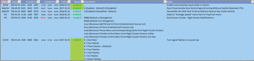

I tweaked my previous 2015 Edge Titanium and would like to apply some of those changes to my new 2019.  Yes. I could just "try it", but what are forums for ?
Has anyone successfully tried the following mods on a 2019 Edge Titanium:
Not tried - Enable view text/new input while in motion (disables traffic and I use that feature occasionally).
Yes, works - Door close double horn honk.
Yes, works - Turn signal flashes on quick tap.
Others (not highlighted)
Yes, works - Secureidle
Not tried - Adds an 'Average Speed' menu

I just can't get the "double horn" to work as it did on  my previous 2015 Titanium.
In desperation, I'm asking if anyone else encountered issues doing this with their 2019 Titanium.

Edge ST (worked for me). This is different location than you are showing (?). 41 vs. 40 (is the shown spreadsheet your record? maybe you recorded it incorrectly?)
Close Double Horn Honk (Engine Running Without Keyfob Detected (PTS)):
726-41-02 (2014+ MY)    xxxX xxxx xxxx         1 (Enabled - Default)        0 (Disabled)
Orig: 0101  0101

Thanks for pointing out the 41 vs 40.  I can't believe I missed this.  I was so sure that's what I used on my 2015... obviously not.  Yes, for me too, it's an absolute requirement to kill that double horn 'alarm clock' sounding at 6:00 a.m.
