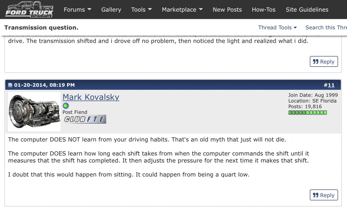

Toby99 Posted September 4, 2020 Author Report Share Posted September 4, 2020 On 9/4/2020 at 3:26 AM, akirby said: Because it DOESNT LEARN YOUR DRIVING HABITS! Sorry for yelling but this is an urban myth that just won’t go away. Nowhere has Ford ever said that. Read what Ford said - it simply measures each shift against the factory target and adjusts the shift pressure to keep it in the target range. This compensates for wear over time and manufacturing tolerances. And it’s based on gear, throttle position and rpm. So it takes a long time for normal driving to hit all of those different combinations. Expand Akirby, I don't doubt what you're saying but that's what I've been told by two different dealer service departments. I just had my Edge Titamiun in again to look at the bucking issue. According to Ford, they were required to reset the PCM before looking at anything else. When I picked up the vehicle the service advisor told me to "give it 1000 - 1500 miles for the car to learn my driving habits". Do you have any documents from Ford you can post that states that? Would like to take it along and give it the the service advisor on my next visit. Quote Link to comment Share on other sites More sharing options...
akirby Posted September 4, 2020 Report Share Posted September 4, 2020 On 9/4/2020 at 12:18 PM, Toby99 said: Akirby, I don't doubt what you're saying but that's what I've been told by two different dealer service departments. I just had my Edge Titamiun in again to look at the bucking issue. According to Ford, they were required to reset the PCM before looking at anything else. When I picked up the vehicle the service advisor told me to "give it 1000 - 1500 miles for the car to learn my driving habits". Do you have any documents from Ford you can post that states that? Would like to take it along and give it the the service advisor on my next visit. Expand That’s because the dealers are just as clueless. Just look up any reference that a Ford makes to adaptive learning. None mention driving style or driving habits. They only say improved shift quality. My information comes from Mark Kovalsky - a retired Ford tranny engineer who worked on the Explorer/Ranger/Lincoln LS 5R55N and later the torqshift truck tranny. He is a member of our Lincoln LS owners club for 20 years now. It was his group that was responsible for the shift calibrations and that is how he explained it. I’ll take his word and Ford’s word over the dealership. Here is a confirmation about the torqshift but all Ford trannys work the same. 1 Quote Link to comment Share on other sites More sharing options...
