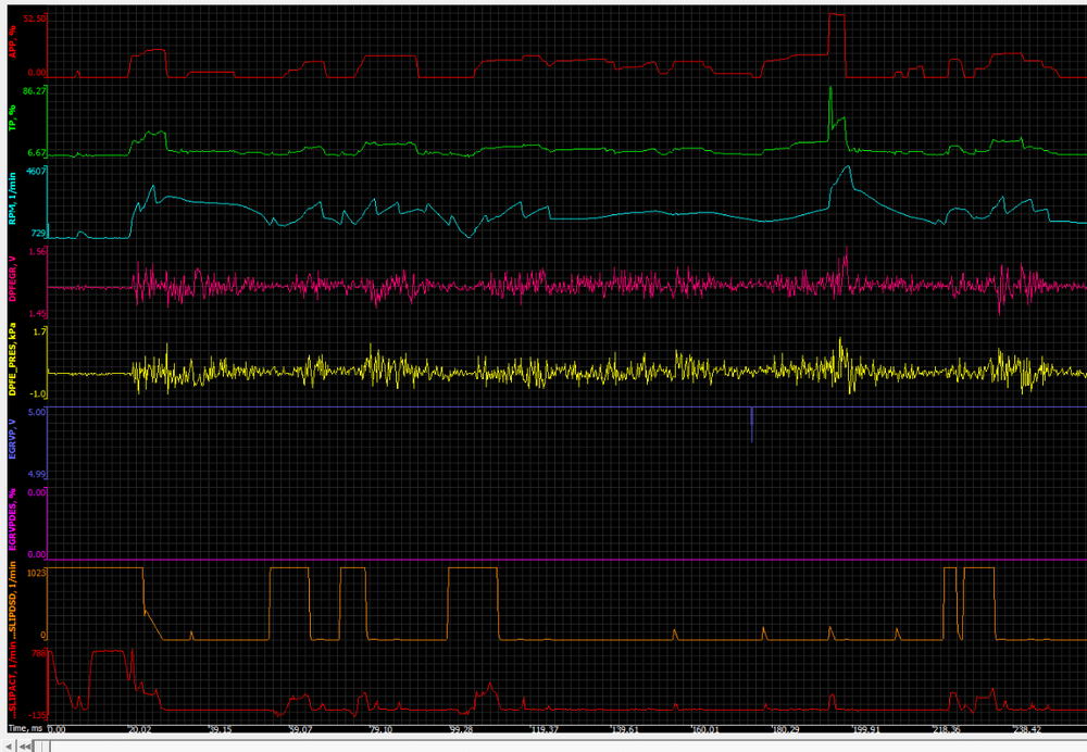

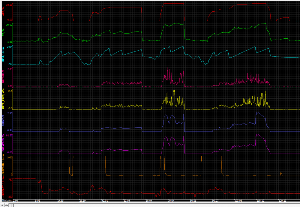

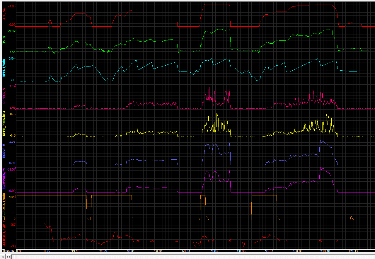

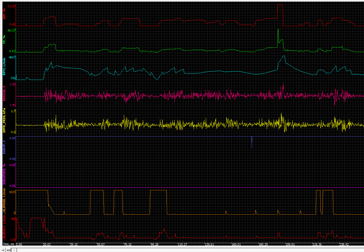

Biker Posted December 22, 2024 Report Share Posted December 22, 2024 There are at least 2 different issues going on. For some, the driveability, bucking etc may wel be the transmission and/or torque converter. For others, this definitely an engine management issue. With my 2019, I tried all the transmission stuff I could, no change. I then changed an egr sensor that fixed it. Until....last week we had a drastic swing in weather from very cold to above freezing, with very high humidity. The low speed bucking and surging was almost unbearable. It's almost like theres no boost or no tps signal in a certain range. Push the throttle a bit more and it launches. Under load its fine. Part throttle, low speed is awful. Once it heated up and likely dried out the offending sensor, all was well. 1 Quote Link to comment Share on other sites More sharing options...
