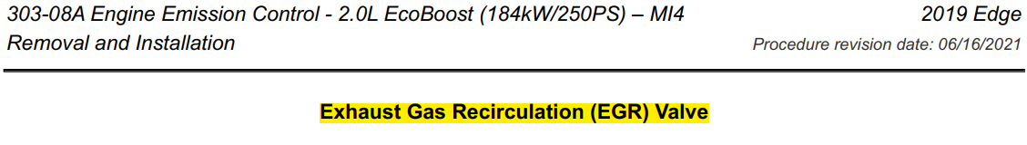

eric1 Posted July 20, 2024 Report Share Posted July 20, 2024 (edited) On 5/25/2024 at 5:19 PM, Haz said: Attached below as PDF documents are the EGR and DPFE sensor removal and installation procedures for 2.0L EcoBoost from the 2019 Edge Workshop Manual, and, location illustrations from the 2019 Edge Wiring resource... Good luck! Exhaust Gas Recirculation (EGR) Valve - Removal and Installation - 2019 Edge Workshop Manual.pdf 1.59 MB · 13 downloads Differential Pressure Feedback Exhaust Gas Recirculation (EGR) Sensor - Removal and Installation - 2019 Edge Workshop Manual.pdf 215.94 kB · 18 downloads EXHAUST GAS RECIRCULATION (EGR) VALVE - 2.0L EcoBoost Location - 2019 Edge.pdf 1.33 MB · 9 downloads Differential Pressure Feedback Exhaust Gas Recirculation (EGR) Sensor - 2.0L EcoBoost Location - 2019 Edge.pdf 1.33 MB · 9 downloads does the egr sensor consist of valves too? Or is it just the sensor? I’m looking to replace the sensor but not sure if I need to replace these valves too In your egr sensor removal diagram it looks like it contains valves too, but when I look up the sensor to purchase it, I just see the sensor Edited July 20, 2024 by eric1 Quote Link to comment Share on other sites More sharing options...
Haz Posted July 20, 2024 Report Share Posted July 20, 2024 (edited) @eric1: You are correct that in the text you quoted, I should've included the word 'valve" after "EGR" to be consistent with that previously attached "Exhaust Gas Recirculation (EGR) Valve" Workshop Manual section... I regret that my omission of the word "valve" unnecessarily lengthened your path toward resolving your Edge's issue. Good luck! Edited July 20, 2024 by Haz 2 Quote Link to comment Share on other sites More sharing options...

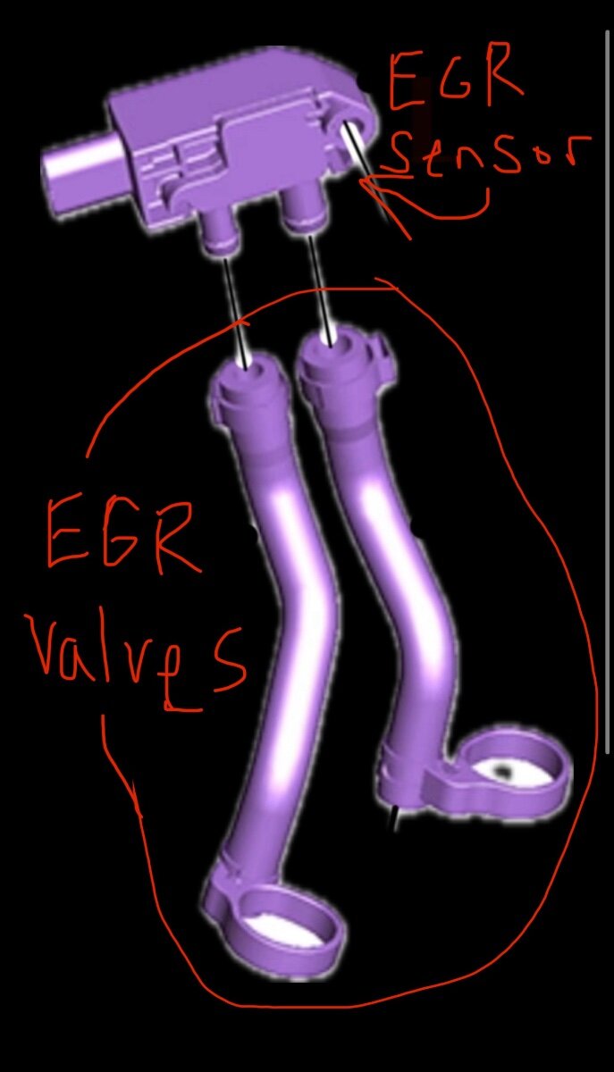

Tonycarlo Posted September 10, 2024 Report Share Posted September 10, 2024 On 9/3/2024 at 5:03 PM, Biker said: Welcome to the party...If you read back a few pages, someone discovered that moisture gets into one of the EGR sensors which is the cause of the bucking for some people. Others have actual transmission issues, but the EGR sensor solved it for me. So, it could be coincidental with the purge valve issue, but the engine management systems all interact to some degree, so I wouldn't be surprised if the purge valve is causing your problem. My take on it is that the turbo 4cyl engines are very sensitive to sensor inputs. Before boost hits, there is not much torque being produced. If a sensor delays or diminishes boost, the engine requires more throttle input which definitely affects transmission shifting. Was it the egr valve or DPFE sensor that was replaced? Or both? Thanks... Quote Link to comment Share on other sites More sharing options...
Biker Posted September 10, 2024 Report Share Posted September 10, 2024 20 hours ago, Tonycarlo said: Was it the egr valve or DPFE sensor that was replaced? Or both? Thanks... I only replaced the DPFE sensor. Good thread on it here: https://www.ranger5g.com/forum/threads/whats-inside-a-dpfe-sensor-pics-inside.26792/ Quote Link to comment Share on other sites More sharing options...
Tonycarlo Posted September 11, 2024 Report Share Posted September 11, 2024 17 hours ago, Biker said: I only replaced the DPFE sensor. Good thread on it here: https://www.ranger5g.com/forum/threads/whats-inside-a-dpfe-sensor-pics-inside.26792/ ok thanks, that looks like the EGR valve sensor not the DPFE though? https://www.summitracing.com/parts/smp-vp41?srsltid=AfmBOopBtSaOPN6WeosR05aPsVf8VRPZbNHboyBZ_RkxMJAgK9XnKHPj Quote Link to comment Share on other sites More sharing options...
