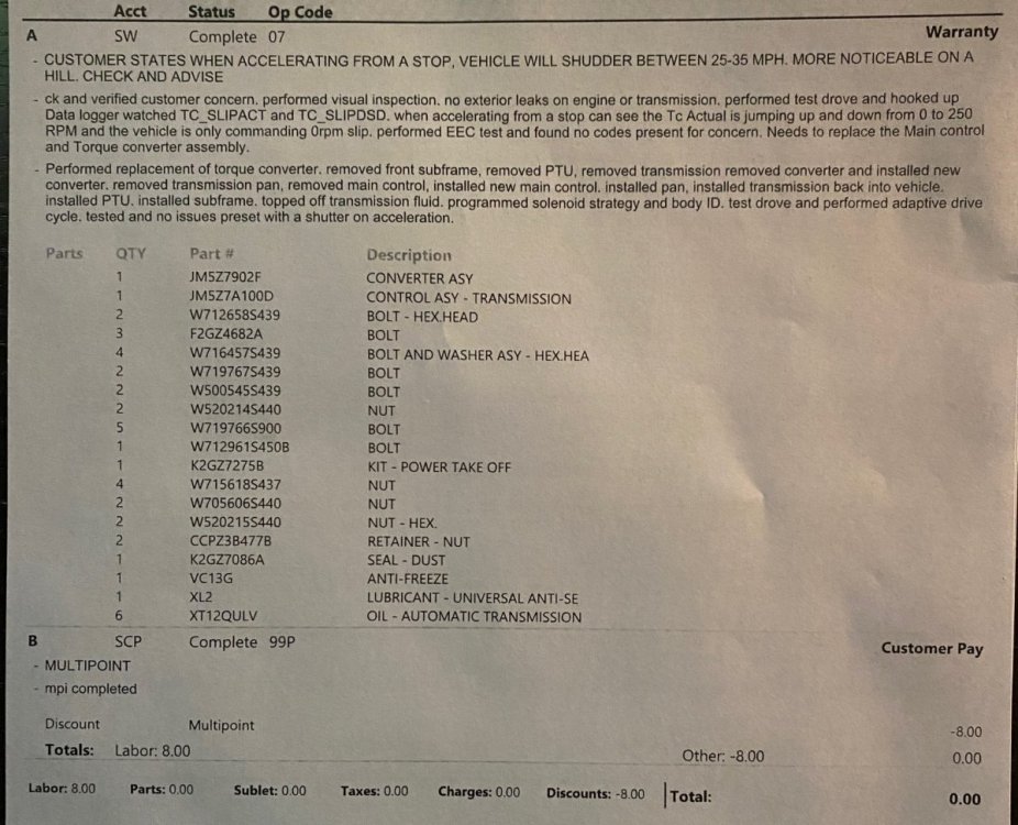

bp_2019EdgeTi Posted May 20, 2023 Report Share Posted May 20, 2023 I had a similar problem on my 2019 with about 57,500 miles on it. The transmission felt like it would shudder between 25-35 MPH. It was particularly noticeable when at a slight incline and under light throttle. My dealership replaced the torque converter and control assembly under warranty. Attached is my service invoice for reference. 1 Quote Link to comment Share on other sites More sharing options...
Toby99 Posted May 20, 2023 Author Report Share Posted May 20, 2023 Could you keep us updated on whether the described repairs fixed the issue? My 2019 Edge is still having slow speed buck/surges after 4-1/2 years. Numerous TSB's and PCM resets have done nothing. Worst vehicle I have ever owned. Quote Link to comment Share on other sites More sharing options...
bp_2019EdgeTi Posted May 22, 2023 Report Share Posted May 22, 2023 As far as I can tell it took care of the problem. It drives as it should now. I tried resetting the adaptives with Forscan prior to taking it in. When I did that, for the first drive after it seemed better but would always return. After the shop replaced the torque converter and valve body, it drives great now. Thankfully, it was under warranty. It wouldn't have been a cheap job otherwise. My work car is a 2020 Ford Edge in a more basic trim level, but it has the same engine and transmission. It has about 20k miles and the transmission shifts perfectly. After the repair, I'd say my 2019 shifts the same as my 2020 work car now. 2 Quote Link to comment Share on other sites More sharing options...

bp_2019EdgeTi Posted June 8, 2023 Report Share Posted June 8, 2023 I had a 2019 that was doing something similar. I only have 57-58K miles. The dealer replaced the torque converter and transmission valve body under warranty which fixed the problem. 1 Quote Link to comment Share on other sites More sharing options...
