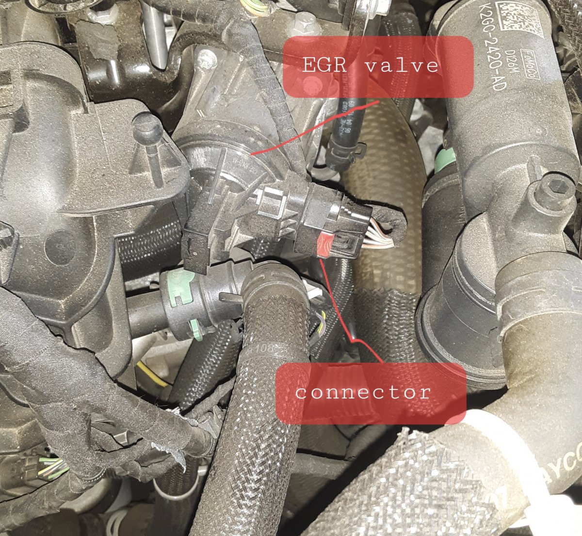

Breez Posted July 7, 2022 Report Share Posted July 7, 2022 Unplugged my EGR valve. Surge/hitching gone. Maybe that will fix it, will let you all know. BTW should be covered under power train warranty. Quote Link to comment Share on other sites More sharing options...

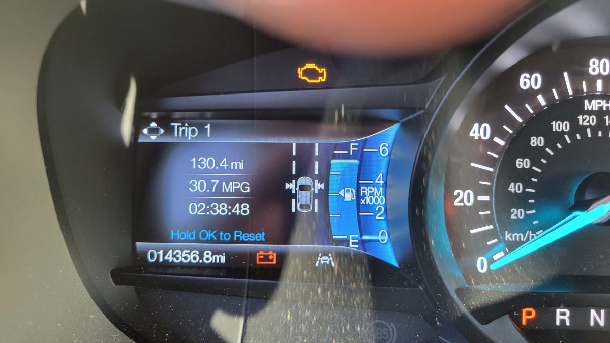

Breez Posted July 8, 2022 Report Share Posted July 8, 2022 (edited) Oh, no I won't leave it unplugged. BTW, I am getting 29.6 mpg, every one else about the same? 2019 with 2.0L Also, will replace the EGR, SENSOR AND TUBES that the sensor hooks up to. Edited July 8, 2022 by Breez Added info Quote Link to comment Share on other sites More sharing options...
Nolan Posted July 8, 2022 Report Share Posted July 8, 2022 15 hours ago, Breez said: BTW, I am getting 29.6 mpg, every one else about the same? 2019 with 2.0L The wife's Edge is averaging 29.8 mpg. 2019 with 2.0L and she likes to drive fast. Quote Link to comment Share on other sites More sharing options...
lildisco Posted July 10, 2022 Report Share Posted July 10, 2022 (edited) Currently sitting ~30.6 on my 2020 SEL. I'm assuming that it'll be ~28 manually calculated. Edited July 10, 2022 by lildisco Quote Link to comment Share on other sites More sharing options...
Toby99 Posted July 10, 2022 Author Report Share Posted July 10, 2022 On 7/7/2022 at 11:17 AM, Breez said: Unplugged my EGR valve. Surge/hitching gone. Maybe that will fix it, will let you all know. BTW should be covered under power train warranty. Breez, Can you explain the connection between the EGR valve and the bucking/surging issue we are having? Is this actually an engine problem and not transmission? Customer support is worthless and I (we) have no direct access to Ford technicial engineering. Just odd to me that no one who has read or posted here are Ford repair techs or a Ford employee. Whether Ford acknowledges it or not there is something wrong with our vehicles. I've lost count on how many TSB's I've had done and resetting the PCM. It's not fixing the problem. I'm also frustrated with dealership service departments that state there are no codes or could not duplicate the problem. 1 Quote Link to comment Share on other sites More sharing options...

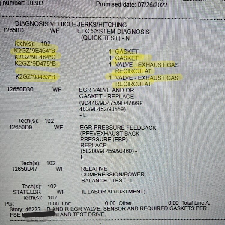

Breez Posted July 13, 2022 Report Share Posted July 13, 2022 (edited) It is very frustrating, you would think that everything, driveability related, would set a code. Not so. Someone told me that a few issues were found with moisture in the egr valve assy. The symptoms are pretty much the same as we are experiencing. But, other issues can mimic these. I unplugged my egr valve and my problem disappeared. Dealer replace EGR parts*******so far, so good. Edited August 17, 2024 by Breez Updated, at 68,000 miles, problem hasn't returned. Quote Link to comment Share on other sites More sharing options...
