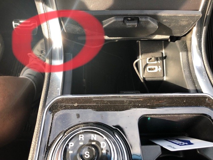

I found a way to get a USB cable out of the media hub. Since the spring loaded door doesn't have a cut-out for the cable, I routed the cable under some trim.

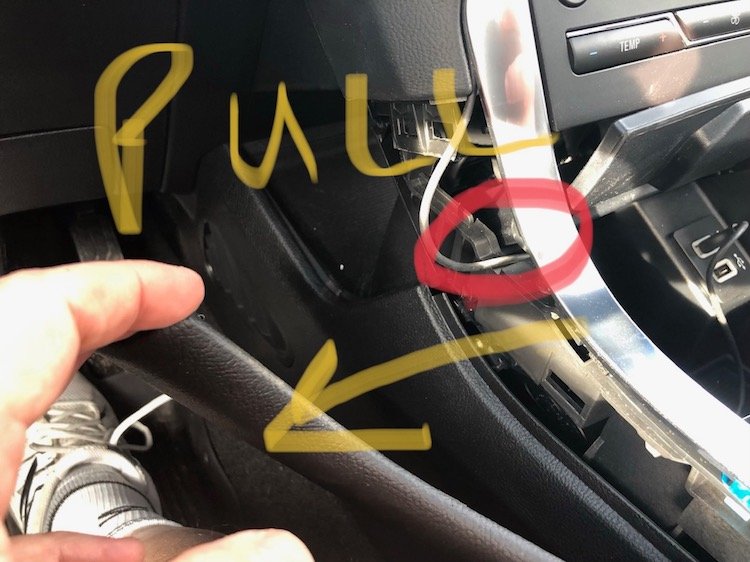

1. Pull the trim. There are tabs easily allow removal and reattachment. I know the other side has a 12V port.
2. Send the USB cable through the small hole (red circle).

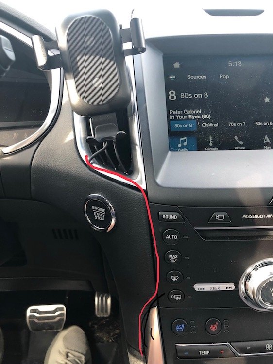

I chose to route it up to a vent phone holder but you could route it back too. The cable was easily pushed between the trim and vent (am thinking of maybe removing the vent to allow it to come in from behind).
