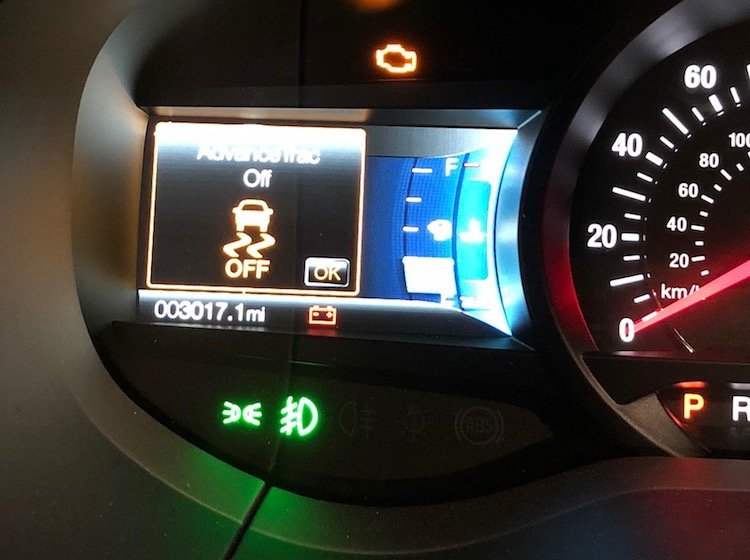

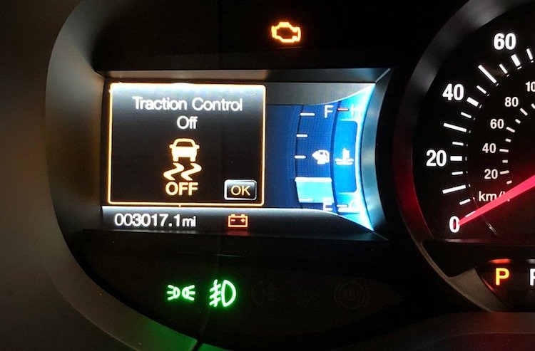

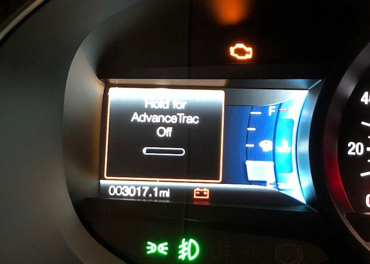

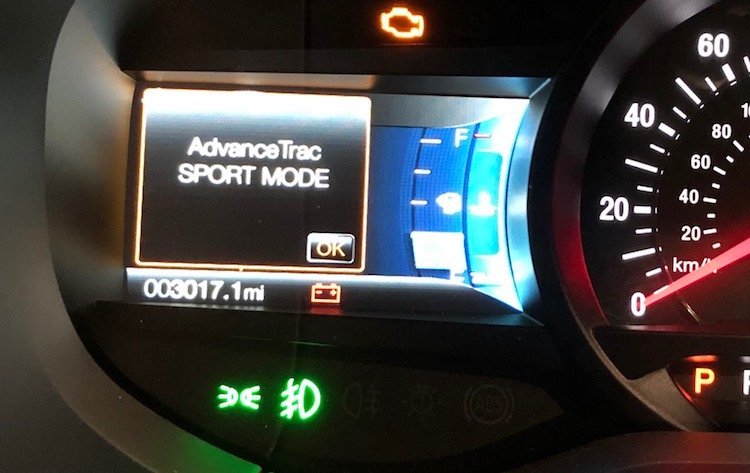

bobyellow Posted April 13, 2019 Report Share Posted April 13, 2019 Just wondering what the 3rd option does... two are shown in the manual (1 & 2 pushes). The ST seems to have a 'hidden' 3rd option (race like the Fusion/Focus?). Presses: 0 - normal mode with car start 1 - Traction control off (stuck in snow/mud or launching at drag strip) 2 - Sport mode, have to push twice quickly. Sport mode which allows the driver to reduce normal electronic stability control system intervention and provide a more spirited driving experience (from manual). Long hold (status bar on display) - 'AdvanceTrac Off' how is this different than 1 quick push? Does this also disable Roll Control? Thanks for any known information. Quote Link to comment Share on other sites More sharing options...
omar302 Posted April 13, 2019 Report Share Posted April 13, 2019 Traction Control is what keeps the wheels from spinning, like on snow or slippery surfaces. Advance Trac is what helps keeps the vehicle from going out of the intended track, usually when turning, think drifting or taking turns sideways. This is accomplished by braking individual wheels and/or cutting engine power. In Advance Trac Sport mode the system is dialed back to some degree to allow some spirited driving, when it is "off", then it is completely off. Quote Link to comment Share on other sites More sharing options...
jamie1073 Posted April 13, 2019 Report Share Posted April 13, 2019 I believe Roll Control can not be disabled. @omar302 hit the nail on the head though, it disables traction control and Advance Trac. So you can do donuts or slide the rear out. Just turning traction control off, one press, will not allow any sliding or kicking out the rear. Sport Mode is nice but I wish they made it like the Focus ST where is pretty much turned off traction but allowed some slippage of the vehicle if you were playing, before intervening. Sport on the Edge kicks in the traction control to quick for my tastes and I never use it because it kicks in to much for wheel spin on take off from a stop say tuning a corner. The Focus would let you light em up if you wanted to in Sport Mode, so much so that if you had a tune using a Cobb Accessport you could use Cobb's traction control instead which was more tuneable, controllable. All you would do is put it in Sport mode to disable the factory and use the Cobb setup which was fuel/brake based instead of just brakes. Anyway fun mode is with it all off on the Edge. Quote Link to comment Share on other sites More sharing options...

omar302 Posted August 12, 2021 Report Share Posted August 12, 2021 (edited) @ANoid: Electronic Stability Control. From the Edge Owners manual: Quote USING STABILITY CONTROL Electronic Stability Control The system automatically turns on each time you switch the ignition on. You can switch off the traction control portion of the system independently. See Using Traction Control. Note: The ESC OFF switch and Sport Mode are only available on the ST model. ESC Features Button Functions Mode Stability Control Off Light Electronic Stability Control Traction Control System Default at start-up - On during bulb check Enabled Enabled Button pressed momentarily Traction control off On Enabled Disabled Button pressed twice rapidly Sport mode (if equipped) On Enabled Enabled Button pressed again after deactivation ESC fully enabled Off Enabled Enabled Note: Do not use the Sport stability control setting on public roadways. Some models may also have a sport mode which allows the driver to reduce normal electronic stability control system intervention and provide a more spirited driving experience. To enter sport mode, toggle the stability control button twice rapidly. The message appears in the information display that the system is now in sport mode. Edited August 12, 2021 by omar302 Quote Link to comment Share on other sites More sharing options...
