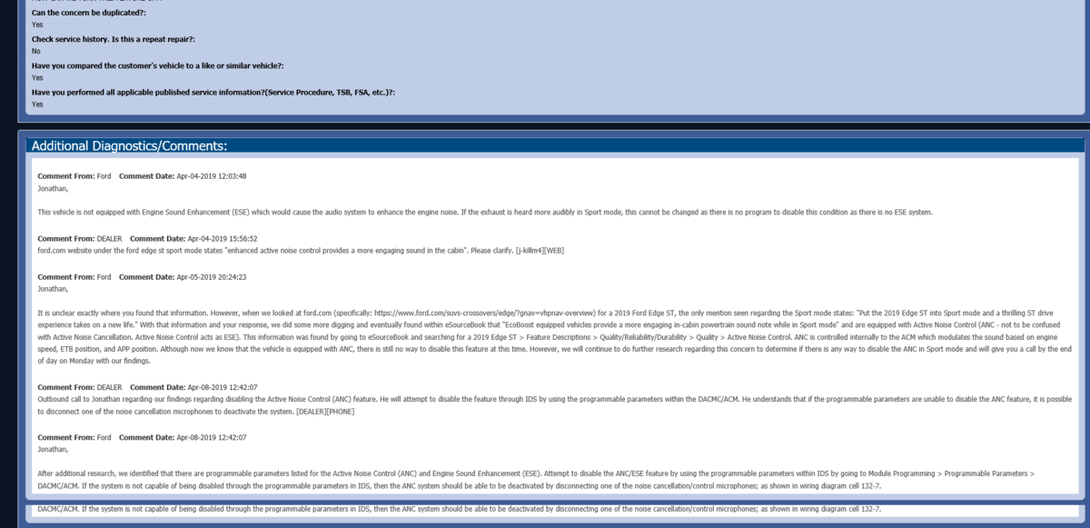

Sage Posted April 10, 2019 Report Share Posted April 10, 2019 (edited) I requested info from Ford, through my Service Advisor, on how to dis-able the enhanced exhaust tone in the cabin while in "Sport" mode. Also, kudos to my Service Advisor for working with me on this. The attached shows a couple of replies from Ford with a couple of possible ways. It will only take a couple of minutes to read the two replies from Ford. Hopefully it will be readable as it is pretty small print. Edited April 12, 2019 by Sage Header update 4 Quote Link to comment Share on other sites More sharing options...

Sage Posted April 11, 2019 Author Report Share Posted April 11, 2019 (edited) OK, per all of the above. I did see one forum member state they changed the code (per the above post), but could not really tell a difference. Maybe there were some others that documented that it worked and I just miss it. I wanted to see if Ford could come up with something. Also, since I do not have the interface/part or forscan itself to use (I do not have a windows laptop either) to change the code listed above, I decided to see what the dealer could do for me. The dealers price was not that much more than me getting everything else to change a code. I do not plan on doing anything else that could be possible with forscan, just a personal choice. If I ever change my mind, there are great resources on this forum. I let the dealer turn off the ANC and ESE and I feel that worked. Also, the tech stated he could disable ANC and ESE separate from each other. Not really knowing for sure which might be better, I had him disable both. For me, the dealer did it with information from Ford and documented what they did. Now I do not have any concern with Ford stating I changed their software, which caused any issues that could come up later. I realize one could change a code back using forscan, but not easy if one is traveling away from home. ********************** I have been activating sport mode at different speeds and I do not hear any enhanced tone from the cabin speakers. The change the dealer did for me worked as far as I can tell. I still suggest, if you want to try the changes, talk to your dealer and see if they can verify what I found out. My ST was a very early build and who knows what may have changed. Edited April 12, 2019 by Sage Quote Link to comment Share on other sites More sharing options...
