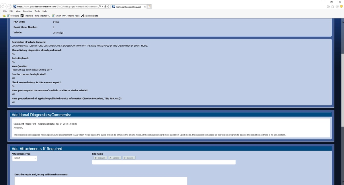

When I put my ST in Sport Mode, the exhaust seems to be enhanced in the cabin by use of the speakers?  I have read others that have stated it is the same for them as well.  I have read a couple of posts that stated on later built ST's there is no enhancement (my ST is an early built).  I have been working with a Ford Service Advisor and he sent a request to Ford, using an internal system, asking how to turn that off.   Below is the reply he got back from Ford, note: it is a screen shot that was sent to me by email.  Not sure how visible it will be, but the reply was that the ST does not have a system called ESE system, there for it does not pipe in exhaust tone, so nothing to turn off.
Comments, does some else know better - been told something different?
Thanks
You can disable it with Forscan but you will also lose active noise cancellation. There are threads about it on here somewhere. Also its BS that they deny it as it is also in all of the literature and I personally heard the difference between the car i test drive (early build) and my car (later build) that either has it toned way down or inactive.
Agree with the above.  The Ford rep who replied is either unaware or misleading.  It's possible that ONLY the engine noise can't be turned off (as mentioned above it'll also turn off noise cancellation) but it's definitely there on our early build and definitely NOT a natural exhaust sound.
