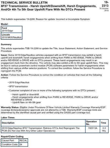

MENINBLK Posted October 21, 2019 Report Share Posted October 21, 2019 I had the TSB applied to my 2019 Edge ST and the 3-4 gear upshifting problems have been solved. There is still a hard upshift when traveling at about 6 mph and coasting. The tranny will shift so hard and the Edge will accelerate, so that I have to apply the brakes. Pete... Quote Link to comment Share on other sites More sharing options...
STEdGeST Posted October 23, 2019 Report Share Posted October 23, 2019 On October 20, 2019 at 11:15 PM, MENINBLK said: I had the TSB applied to my 2019 Edge ST and the 3-4 gear upshifting problems have been solved. There is still a hard upshift when traveling at about 6 mph and coasting. The tranny will shift so hard and the Edge will accelerate, so that I have to apply the brakes. Pete... Have had that issue as well. Quote Link to comment Share on other sites More sharing options...
BillE Posted October 24, 2019 Report Share Posted October 24, 2019 (edited) On 10/20/2019 at 11:15 PM, MENINBLK said: I had the TSB applied to my 2019 Edge ST and the 3-4 gear upshifting problems have been solved. There is still a hard upshift when traveling at about 6 mph and coasting. The tranny will shift so hard and the Edge will accelerate, so that I have to apply the brakes. Pete... Are you saying that you have had TSB 19-2313 which was announced on 10/16 2019 already applied? My dealer wasn’t scheduled to receive the software for TSB 19-2313 until 10/23/2019. I am scheduled to have it applied on 10/25/2019. Edited October 24, 2019 by BillE Typo on TSB number Quote Link to comment Share on other sites More sharing options...
IWRBB Posted October 24, 2019 Report Share Posted October 24, 2019 We are going to try the 192313 update as soon as we can get it in. Still getting harsh shifts after the last re-flash- mainly from park to drive. Quote Link to comment Share on other sites More sharing options...
Perblue Posted October 24, 2019 Report Share Posted October 24, 2019 I'm booked in for tomorrow morning at 9. 1 Quote Link to comment Share on other sites More sharing options...
CTCLUES Posted October 24, 2019 Report Share Posted October 24, 2019 I take delivery on a new 2019 Edge ST at the end of the month. Should I insist they update the PCM with the 9-2313 update before I take delivery? Or should I wait and see if my vehicle exhibits any of the symptoms described? In other words, is this TSB a software update? Or is it more like a remedy that only fixes vehicles with issues? PS - I am very excited to get behind the wheel! Quote Link to comment Share on other sites More sharing options...
akirby Posted October 24, 2019 Report Share Posted October 24, 2019 11 minutes ago, CTCLUES said: I take delivery on a new 2019 Edge ST at the end of the month. Should I insist they update the PCM with the 9-2313 update before I take delivery? Or should I wait and see if my vehicle exhibits any of the symptoms described? In other words, is this TSB a software update? Or is it more like a remedy that only fixes vehicles with issues? PS - I am very excited to get behind the wheel! It's a software update and I would absolutely ask that it be done prior to delivery. They can't do it until the vehicle is sold. Just say that you noticed some poor shifting on the test drive - that should be all they need to do it. Quote Link to comment Share on other sites More sharing options...
BlueSteel Posted October 24, 2019 Report Share Posted October 24, 2019 1 hour ago, akirby said: It's a software update and I would absolutely ask that it be done prior to delivery. They can't do it until the vehicle is sold. Just say that you noticed some poor shifting on the test drive - that should be all they need to do it. I'm picking up a new ST on tomorrow, and they said I should wait to see if there are symptoms. I bought another Edge ST two months ago, but it was totalled in an accident. I didn't notice any flares, but then again, I only had it for two months. Quote Link to comment Share on other sites More sharing options...
