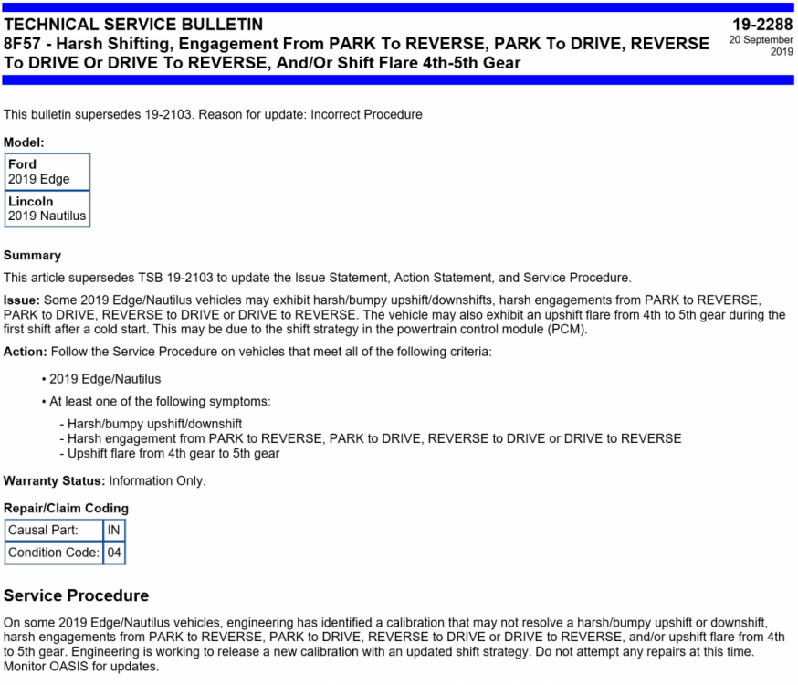

Dingle Posted October 5, 2019 Report Share Posted October 5, 2019 There's a new TSB out (19-2288) that supersedes the previous TSB (19-2103) for the transmission. Though the wording on it seems somewhat conflicting. 1 1 Quote Link to comment Share on other sites More sharing options...
jamie1073 Posted October 6, 2019 Report Share Posted October 6, 2019 Good to see they are still working on it but damn it has been months so far and still no resolution. What is up with Ford lately. They have this issue with the Edge/Nautilus and the Explorer/Aviator is having electronic issues as well. I wonder if the new Escape/Corsair will have issues with its 8 speed trans as well. 1 Quote Link to comment Share on other sites More sharing options...
akirby Posted October 6, 2019 Report Share Posted October 6, 2019 56 minutes ago, jamie1073 said: . What is up with Ford lately. Probably a combination of losing experienced engineers and diverting resources to work on autonomous vehicles and hybrids/BEVs and other new things. Very disappointing. Quote Link to comment Share on other sites More sharing options...
Jombi Posted October 6, 2019 Report Share Posted October 6, 2019 (edited) Also, this 8-speed is GM's modified 9-speed--with a gear removed. Right there that says there was a design and a calibration strategy that had to be jury-rigged by Ford right out of the gate. Not sure if that has anything directly to do with it but this is a hacked tranny from the get-go. Sorry, my info was wrong, this is the re-designed 6-speed, the GM-build 9-to-8 speed was for lower torque cars. Edited October 6, 2019 by Jombi Incorrect info Quote Link to comment Share on other sites More sharing options...

akirby Posted October 6, 2019 Report Share Posted October 6, 2019 1 hour ago, Jombi said: Also, this 8-speed is GM's modified 9-speed--with a gear removed. Right there that says there was a design and a calibration strategy that had to be jury-rigged by Ford right out of the gate. Not sure if that has anything directly to do with it but this is a hacked tranny from the get-go. Sorry, my info was wrong, this is the re-designed 6-speed, the GM-build 9-to-8 speed was for lower torque cars. Why would you say it’s jury rigged? They tested the 9 speed and found issues so they removed a gear. Each company does their own software. GM has also had problems with their 9 speed. Removing a gear wasn’t the problem. Quote Link to comment Share on other sites More sharing options...
Jombi Posted October 6, 2019 Report Share Posted October 6, 2019 7 minutes ago, akirby said: Why would you say it’s jury rigged? They tested the 9 speed and found issues so they removed a gear. Each company does their own software. GM has also had problems with their 9 speed. Removing a gear wasn’t the problem. I just said it was something that may be a possibility, but it's moot now, I did edit my post because I'd realized the Edge ST 8-speed was not the GM "rigged" 9-speed, it was Ford's upgraded 6-speed. Either way, it's still not optimal. If something is drawn up to be a 9-speed and a gear is removed, sure maybe that's not ruinous, but it's a significant change from the engineers' original design so it is simply not optimal. Quote Link to comment Share on other sites More sharing options...
