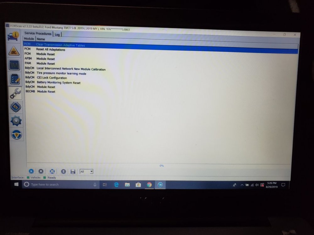

Kubicide Posted June 28, 2019 Report Share Posted June 28, 2019 Slipping in another update: my ST continues to shift absolutely fine. Flushing the adaptive cache corrected the poor shifting. It's now been almost six weeks and the tranny shifts exactly the same as it did right after the flush and when it was driven off the lot back in January. No slip or hang or lag in the 2-3 and 3-4 changes. And 7-8 both shift predictably and exactly when expected. I have not gone in for the TSB... 2 Quote Link to comment Share on other sites More sharing options...
WWWPerfA_ZN0W Posted June 29, 2019 Report Share Posted June 29, 2019 Kubicide, is this the KAM reset for the PCM or the adaptive tables for the TCM? Quote Link to comment Share on other sites More sharing options...
Kubicide Posted July 2, 2019 Report Share Posted July 2, 2019 The adaptive tables. Right at the top of the list in Forscan. Would be curious to hear the results from someone else - seems like no one has tried this in this thread which is too bad. Quote Link to comment Share on other sites More sharing options...

ktp1598 Posted August 30, 2019 Report Share Posted August 30, 2019 (edited) Update.. I reset "Clear transmission adaptive tables" last night and took it out for a test drive. Wife said it shifted so much better that if it stays like this she'll be super happy. First time I've seen her giggle when driving it. So, if it learns the crappy shifting again I'll have to do another reset. Is there any way to turn "adaptive learning" off? I didn't go into the PCM, just reset from the service procedures screen. If this can be turned off our problem will be fixed 100%. **Pay no attention to the vehicle at the top. I was modifying a few things on my car and looked for this while I was at it. Hers was done later that night. Edited August 30, 2019 by ktp1598 Quote Link to comment Share on other sites More sharing options...
