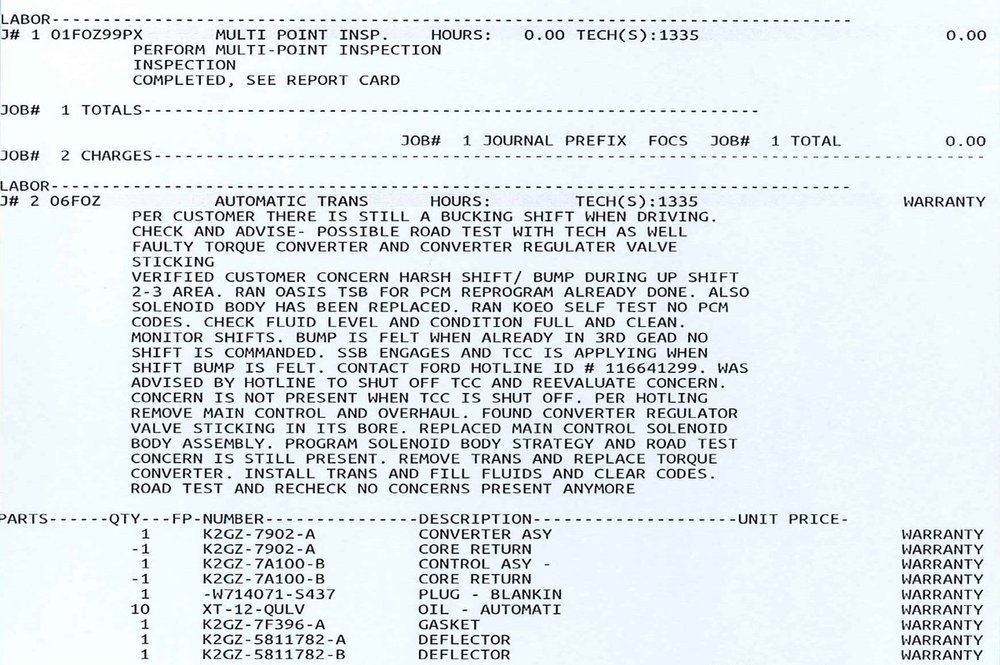

Fingernip Posted May 31, 2019 Author Report Share Posted May 31, 2019 Dealer just called me and said they were instructed by Ford to disconnect the TCC solenoid and test it for the same condition and it no longer bucks. So now they have a new torque converter on order. Sucks they are going to disassemble my car to that degree. Quote Link to comment Share on other sites More sharing options...

Fingernip Posted May 31, 2019 Author Report Share Posted May 31, 2019 2 minutes ago, akirby said: Just because someone is having shift issues doesn't necessarily mean it's the software or that it's the same problem as others. Sometimes it's just a hardware issue. Listening to others complaints I realized that mine is somewhat unique also. It was not a shifting delay or laziness. My car has a jerking/bucking motion at low steady speed after shifting into 3rd. Now that I think of it its right when the TC would lock up. It has always had a hard lockup almost like shifting into another gear. I have a 2002 F250 diesel that had a similar issue due to the TC solenoid being submerged in trans fluid and the fluid being excessively dirty causing the solenoid electronics to short. It got bad enough to go into limp mode. I suspect with more time the edge would eventually trigger a fault when RPMs don't drop or it flares during the bucking. The bucking is violent enough to spill drinks in the car. Quote Link to comment Share on other sites More sharing options...

akirby Posted June 6, 2019 Report Share Posted June 6, 2019 10 hours ago, Fingernip said: I have a little over 3000 miles on mine and it progressively worsened over time. Probably 90% is city and very short commutes (3miles or less). After the TSB is was a bit better for about a day and came back worse than before. At one point it began clunking into reverse and drive as if it had low trans fluid. That cleared up on its own but the bucking in 3rd was like someone who is learning to drive a manual. That sounds like a hardware issue (torque converter maybe). Quote Link to comment Share on other sites More sharing options...
Fingernip Posted June 6, 2019 Author Report Share Posted June 6, 2019 49 minutes ago, akirby said: That sounds like a hardware issue (torque converter maybe). New converter should be installed today. I'm hoping its resolved as I absolutely hate the loaner explorer I'm driving. I'm also hoping not to see damaged wheels and tore up lug nuts. Quote Link to comment Share on other sites More sharing options...
akirby Posted June 6, 2019 Report Share Posted June 6, 2019 38 minutes ago, Fingernip said: New converter should be installed today. I'm hoping its resolved as I absolutely hate the loaner explorer I'm driving. I'm also hoping not to see damaged wheels and tore up lug nuts. Oops - I forgot you were the one getting the new TC. You should have mentioned that. Quote Link to comment Share on other sites More sharing options...

Fingernip Posted June 13, 2019 Author Report Share Posted June 13, 2019 (edited) Just picked up my car. I have only driven to the gas station and back to work so not much seat time yet but so far so good. It is shifting very smooth and without the bucking 3rd gear. I did notice some clunks into gear that i will have to keep an eye on. Ill check trans fluid level when I get home also. Ill tell you the power difference and basic handling between a 3.5L 2019 explorer and the edge ST is MASSIVE. I missed my ST so much. The torque is fantastic and seems to always have tons of available power no matter what speed you are driving. Ill scan the service report later but it basically said they found the TC control solenoid was sticking and actually confirmed the piston was sticking in the bore. They replaced that and also the torque converter. Edited June 14, 2019 by Fingernip Quote Link to comment Share on other sites More sharing options...
Fingernip Posted June 17, 2019 Author Report Share Posted June 17, 2019 I have put about 100 miles on it since and it’s driving great. I have really no complaints for how it shifts in D or S. I am very happy with how it feels around town under light and heavy throttle. Quote Link to comment Share on other sites More sharing options...
