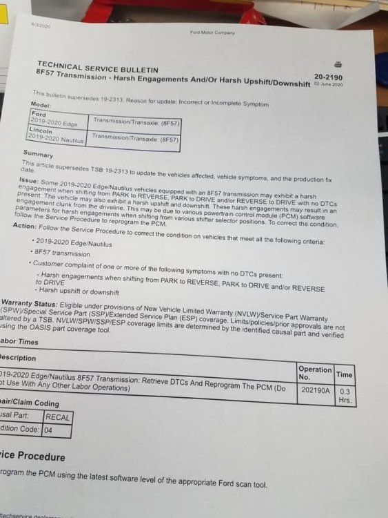

aphxtwinin Posted June 6, 2020 Report Share Posted June 6, 2020 New TSB released 5 1 Quote Link to comment Share on other sites More sharing options...
TomCinMI Posted June 6, 2020 Report Share Posted June 6, 2020 We can't thank you enough, @aphxtwinin! Quote Link to comment Share on other sites More sharing options...
aphxtwinin Posted June 6, 2020 Report Share Posted June 6, 2020 no problem, someone else shared it on FB and I wanted to make sure it was shared here too. I got it applied yesterday felt good after getting it back but it usually does when it's warm. I took it out this morning and it felt solid. I get a hard shift/buck at the same points during my morning drive that it's basically predictable, it didn't happen this time. I also tried to reproduce it like I have in the past and it didn't happen. Shifting feels better between 3/4. I'm cautiously optimistic since it's a small sample size but this could be it. 2 Quote Link to comment Share on other sites More sharing options...
vmaxbaby Posted June 11, 2020 Report Share Posted June 11, 2020 Hello aphxtwinin, So now that you have run it for almost a week everything still seem solid? Any difference in shifting from 1-3 I know you said 3/4 is better. Quote Link to comment Share on other sites More sharing options...
aphxtwinin Posted June 12, 2020 Report Share Posted June 12, 2020 16 hours ago, vmaxbaby said: Hello aphxtwinin, So now that you have run it for almost a week everything still seem solid? Any difference in shifting from 1-3 I know you said 3/4 is better. Everything is still solid, no harsh engagements and all shifts are smooth! 3 Quote Link to comment Share on other sites More sharing options...
vmaxbaby Posted June 29, 2020 Report Share Posted June 29, 2020 I got mine done on Wednesday and took it for a 2 hour drive up and down mountains. Shifts feel good, seems a little quicker and so far no clunking. Driving it to North Carolina for the ST experience in a few weeks so will see how that trip goes. 1 Quote Link to comment Share on other sites More sharing options...

Perblue Posted July 14, 2020 Report Share Posted July 14, 2020 5 hours ago, IWRBB said: We've had the latest update since March and so far no clunks. Nice job Ford. The latest update was released June 2nd. I've had it for a week and so far no complaints. 1 Quote Link to comment Share on other sites More sharing options...
BillE Posted July 22, 2020 Report Share Posted July 22, 2020 I purchased a new 2019 Edge ST on 8/31/19. I requested that TSB 19-2313 be flashed on 10/25/19 to address, 1) harsh upshifts and downshifts and 2) harsh engagements when shifting from PARK to REVERSE, PARK to DRIVE and/or REVERSE to DRIVE . TSB 19-2313 was also suppose to address 3) upshift flare on the 4th to 5th gear upshift (since I don’t know what it is, I can’t say if I experienced It). Although not mentioned in the TSB, I hoped it would correct the funkiness in the 3rd to 4th gear upshifting. (skipping 3rd gear?? ) Flashing TSB TSB19-2313 resulted in significant improvement to items 1) and 2). However, I still experienced an occasional harsh engagement. The funkiness of the 3rd to 4th upshifting was not corrected. TSB 20-2190 was rolled out on 6/2/2020. It was suppose to address the same Items 1)and 2) from TSB 19-2313 mentioned above. I had TSB 20-2190 flashed on 7/15/2020. I was hoping as a minimum it would eliminate the occasional harsh engagement. After driving my Edge ST for a week, I can report that my Edge ST feels like a different car. All of my transmission concerns have been corrected by TSB 20-2190. Please note however, that I am 71 years old and not an overly aggressive driver. As such what satisfies me might not satisfy you. 2 Quote Link to comment Share on other sites More sharing options...
