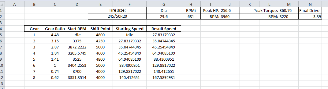

Perblue Posted January 15, 2020 Report Share Posted January 15, 2020 11 hours ago, Fingernip said: I just did some quick math to help the discussion further. I'm sure there are alot of other variables and potentially even errors. Feel free to look it over and see what you think. From my calculations though using our known final drive, tire diameter and the 1st 6 gears we should have shift points under 5000 for maximum effectiveness. revving beyond 5k just shortens the effectiveness of the next gear and pulls it further out of the power-band. Average shifts should be 4556RPM according to my math (please someone check it) Gear Ratios.xlsx The factor you are missing is the increased torque/power that you are getting from the previous gear. There is a reason why cars are dyno'd as close to 1:1 as possible. Gears multiply torque so shifting before 5k can actually hurt because shifting into a higher gear puts you into less power because of the higher gear multiplier than you are losing in the higher rpm. Same with hp since (torque*speed)/5252=hp. Using Livernois's dyno'd wheel results at 3200 rpm, 4000rpm(peak hp) and 5500 rpm 1 1,613torque 983hp 1501torque 1143hp 838torque 878hp 2 1134torque 691hp 1055torque 804hp 589torque 617hp 3 1033torque 630hp 962torque 732hp 537torque 562hp 4 662torque 403hp 616torque 470hp 344torque 360hp 5 544torque 331hp 472torque 360hp 263torque 276hp 6 360torque 217hp 335torque 256hp 187torque 195hp 7 266torque 162hp 248torque 189hp 138torque 145hp 8 223torque 136hp 208torque 158hp 116torque 121hp You can see that there isn't a gear worth shifting early in and that 2 to 3 being as small as it is can still benefit. Quote Link to comment Share on other sites More sharing options...
Fingernip Posted January 15, 2020 Author Report Share Posted January 15, 2020 (edited) 3 hours ago, Perblue said: The factor you are missing is the increased torque/power that you are getting from the previous gear. There is a reason why cars are dyno'd as close to 1:1 as possible. Gears multiply torque so shifting before 5k can actually hurt because shifting into a higher gear puts you into less power because of the higher gear multiplier than you are losing in the higher rpm. Same with hp since (torque*speed)/5252=hp. Using Livernois's dyno'd wheel results at 3200 rpm, 4000rpm(peak hp) and 5500 rpm 1 1,613torque 983hp 1501torque 1143hp 838torque 878hp 2 1134torque 691hp 1055torque 804hp 589torque 617hp 3 1033torque 630hp 962torque 732hp 537torque 562hp 4 662torque 403hp 616torque 470hp 344torque 360hp 5 544torque 331hp 472torque 360hp 263torque 276hp 6 360torque 217hp 335torque 256hp 187torque 195hp 7 266torque 162hp 248torque 189hp 138torque 145hp 8 223torque 136hp 208torque 158hp 116torque 121hp You can see that there isn't a gear worth shifting early in and that 2 to 3 being as small as it is can still benefit. I think I understand. I failed to factor the torque even outside the peak powerband in a lower gear vs the torque within the powerband with less multiplication provided by a higher gear. The only issue though now with a 5500rpm shift point is the close gear ratio has you theoretically enter 3rd gear at 5000rpm at 45mph and shift again at 50mph. I guess that is where the skipped gear comes into play. Skipping 2nd shifts into 3rd at 31mph and 3500rpm (Theoretically). Edited January 15, 2020 by Fingernip Quote Link to comment Share on other sites More sharing options...
