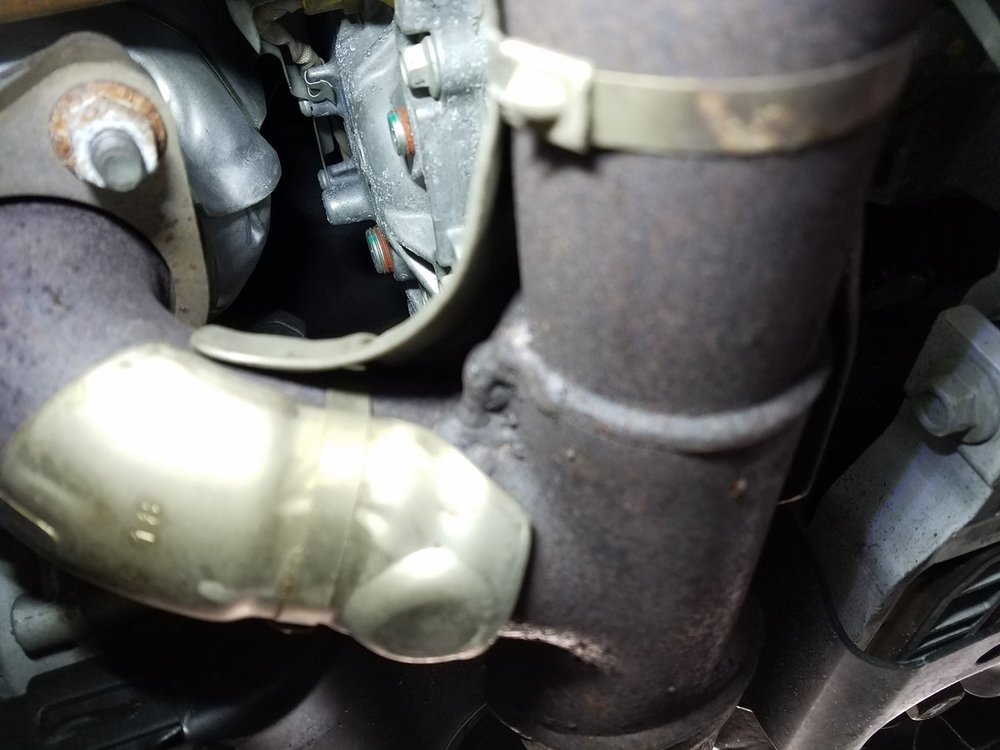

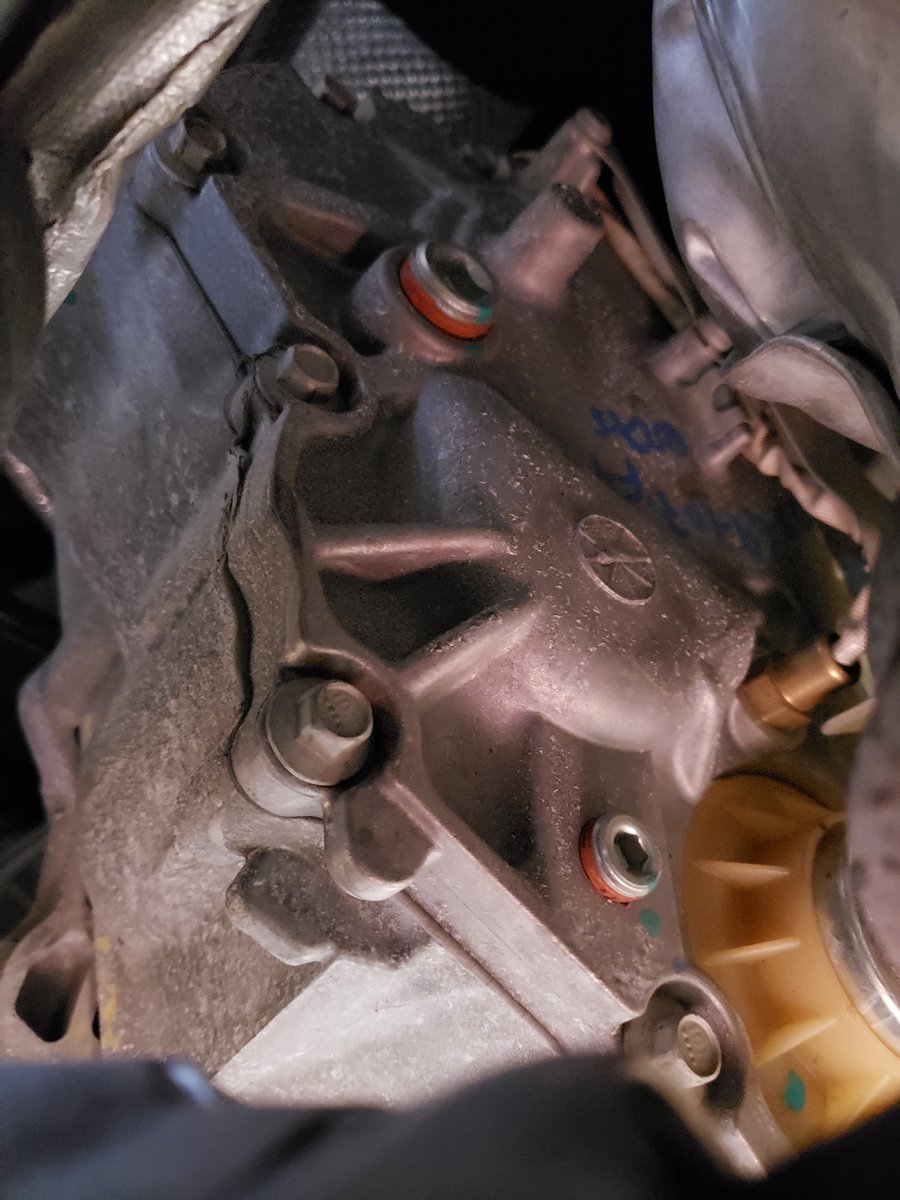

After reading the many posts here I talked to the service guy at the dealer about my new to me CPO Ford Edge PTU with nearly 29k miles on it.
Not sure if you can see from the picture but there are paint marks on the drain and fill plugs so if one were to service this unit themselves it would probable void the warranty.
I asked the service guy if it would be a good idea to change the fluid with summer driving coming up, he assured me no service was necessary on the PTU before 100,000 miles.

Why would changing the PTU fluid void the warranty?
I wouldn't believe that at all. The tech is just telling you what Ford Corporate tells the service manager to tell the techs to tell the customers.
The fluid is not life long.  The fluid should be drained and filled at least once a year, or every third oil change depending on how you drive etc.
The green paint marks are a factory quality check indication to the inspector that the plugs have been tightened/torqued - no way they can be used to tell if the plugs were removed - the orange color is a thread sealant.
The salesman is talking BS about the tires putting the PTU at risk, seeing at the Rear Drive Unit uses a clutch to engage it, and he's also bullshitting about running the oil in the PTU to 100K miles.
I changed my PTU oil to a good quality synthetic at 5K miles and will do so every 20-30K miles.

So why didn't he just agree to change the fluid? Something like, "Yea I can change it for you. It'll cost you $xxx" was what I was expecting. Uhhh me customer?
I mentioned how close the catalytic converter was to the PTU, and he said I could talk to one of his experts but it's good for a 100,000 miles.
Guess I could try another Ford dealer. Not sure I want to do this myself, it's really tight in there.

The fill plug, spec'd at 33 ft lb.  the drain plug, no idea.  Ford does not officially acknowledge the drain plug in Gen 2 PTUs, and many dealers are likely unaware of it as well.  If you insist on the fact it has both a drain and fill plug, it is meant to be drained, you will likely be able to get their trans tech to service the ptu.
Not sure what there is to explain?  The experience of many owners when asking their gen 2 ptus to be serviced by the dealer is one of suprise by service advisors and techs at the mention of the drain plug.  So, the conclusion I draw from that is that it is likely that they have not been briefed on this feature during sales OR service training by Ford.  The manual DOES make mention of the drain plug (33 ft lb now that I check) in the draining and filling section, so I do not understand why that is an issue at the dealership, other than Ford policy/training.

Mine is the 3.5L PTU, probable similar to the 2.7L except the drain plug is not on the bottom but the side and it's smaller than T50. Hard to see what the fill side is don't think it's Torx.
Still getting tools together for this.
When I put the car up on ramps, it won't be level and not sure I can fill it properly.

It was a nice day, about 60 degrees so I decided to crawl around under my new car.
After a couple of short trips the temp of the PTU case was 196 degrees.
The drain plug appears to be 1/4inch hex. I think someone posted it was 8mm, no way. 7mm way to big and 1/4 fits well with just a tiny bit of play.
Do they make 6.5mm or is that to close to a 1/4? I don't have a 6.5mm in my set.
It's really tight in there and still not sure I want to do this myself.
