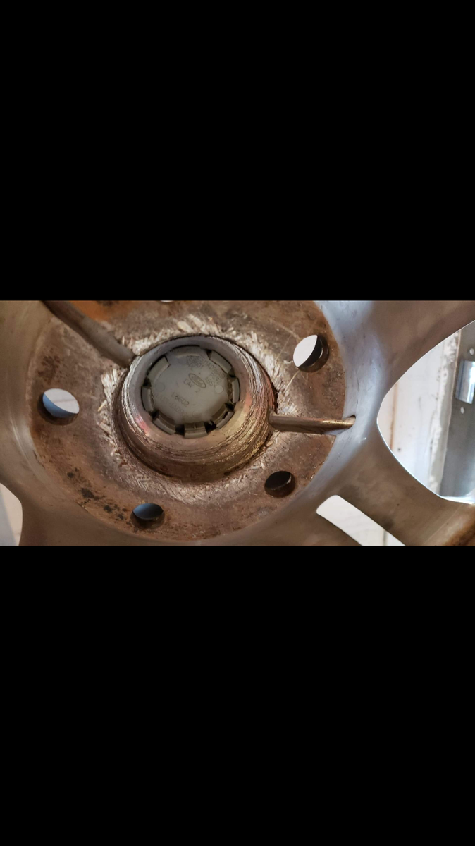

Muff1231 Posted March 14, 2019 Report Share Posted March 14, 2019 (edited) Hey guys in need of some help before I purchase some wheels, a guy has a set of 22Inch sport wheels off a 2013, and the wheel hub was bore out by the previous owner to fit an older Ford Edge, he has them super cheap and was wondering if this will effect anything? I’m buying for my 2013 SEL Edge.. are these worth buying? And will I run into any fitment issues or ride issues! Here’s a pic of the wheel hub! Thanks. Edited March 14, 2019 by Muff1231 Quote Link to comment Share on other sites More sharing options...
onyxbfly Posted March 14, 2019 Report Share Posted March 14, 2019 Unfortunately those wheels will no longer fit your edge. The first gen has a larger hub size. He had the hub bored out to 70.5MM. Your hub is 63.4MM 1 Quote Link to comment Share on other sites More sharing options...
2nd Edge Posted March 14, 2019 Report Share Posted March 14, 2019 if they ft a 2013 and yours is a 2013...hmm they should fit, especially if the bore hole was enlarged to pass over the hub ends if i am reading your description correctly 1 Quote Link to comment Share on other sites More sharing options...
Muff1231 Posted March 14, 2019 Author Report Share Posted March 14, 2019 Yeah the wheel hub was bored out bigger than my vehicle, my 2013 is 63mm and the guy had them bore out to fit his 2009 and that’s 70mm, just was curious, if the wheel hub is larger than my car will I have any ride issues? Quote Link to comment Share on other sites More sharing options...
2nd Edge Posted March 14, 2019 Report Share Posted March 14, 2019 the wheels on the edge are LUG centric vice hub centric so as long as you torque down the lug nuts to proper specs they should work out, as in the lug nuts will center the wheel in the studs. 1 Quote Link to comment Share on other sites More sharing options...
onyxbfly Posted March 14, 2019 Report Share Posted March 14, 2019 You will need a hubcentric ring adapter. You will face issues if you decide not to use one. They're not expensive. Some of the wheel/ tire experts will sort you out. 2 1 Quote Link to comment Share on other sites More sharing options...
Fingernip Posted March 18, 2019 Report Share Posted March 18, 2019 (edited) On 3/14/2019 at 6:09 PM, onyxbfly said: You will need a hubcentric ring adapter. You will face issues if you decide not to use one. They're not expensive. Some of the wheel/ tire experts will sort you out. Great advice. A lot of aftermarket wheels with universal fit will come with rings for the more common hub sizes. Without it you are relying solely on the lug nuts to center the wheel and will be a bit more difficult to install/remove them. Edited March 18, 2019 by Fingernip 2 Quote Link to comment Share on other sites More sharing options...
WWWPerfA_ZN0W Posted March 18, 2019 Report Share Posted March 18, 2019 As long as enough material is left in the bore, the wheels should work. I think I have seen 1 or 2 gen 1 Edges running gen 1.5 Sport wheels. Quote Link to comment Share on other sites More sharing options...
