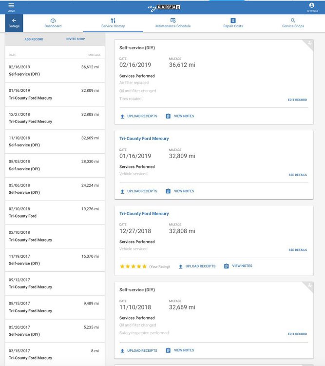

When I recently bought my wife's 2015 Mustang from a private individual, CarFax did not show all the oil changes, so I waited for the seller to get copies of the service record from Bill Collins Ford, and only after confirmation that its service record was good did I make my decision to purchase - with all the electronic records etc. these days it reduces the risk buying used.
Below is my Sport's records showing my DIY and the Dealership services.
