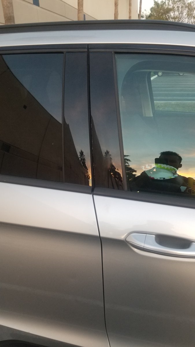

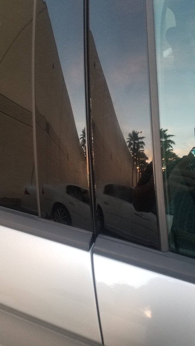

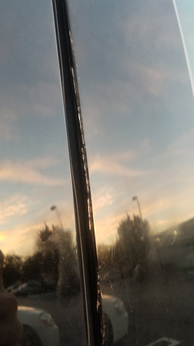

baseballfanatic2@yahoo.com Posted March 5, 2019 Report Share Posted March 5, 2019 Thief tried breaking into my car. Is this piece replaceable? It seems like it's made of glass? Looks kinda cracked. Very ugly when it's light outside. Quote Link to comment Share on other sites More sharing options...
ONEDGE16 Posted March 5, 2019 Report Share Posted March 5, 2019 It's replaceable: Applique - Ford (FT4Z-5820554-B) you have to remove the door inside trim and I believe there's a couple of bolts that hold it in place. Quote Link to comment Share on other sites More sharing options...
baseballfanatic2@yahoo.com Posted March 5, 2019 Author Report Share Posted March 5, 2019 4 hours ago, ONEDGE16 said: It's replaceable: Applique - Ford (FT4Z-5820554-B) you have to remove the door inside trim and I believe there's a couple of bolts that hold it in place. Should I atttempt to fix it myself? Or is this something I should take to ford? Quote Link to comment Share on other sites More sharing options...
ONEDGE16 Posted March 5, 2019 Report Share Posted March 5, 2019 1 hour ago, baseballfanatic2@yahoo.com said: Should I attempt to fix it myself? Or is this something I should take to ford? Depends on your comfort level proceeding with the repair yourself. I would start searching for any online videos to assess complexity of the change and then make a decision from there. Quote Link to comment Share on other sites More sharing options...
omar302 Posted March 5, 2019 Report Share Posted March 5, 2019 Here is the procedure for a 2015, the 2019 will probably be the same. Front Door Upper Moulding.pdf Quote Link to comment Share on other sites More sharing options...
baseballfanatic2@yahoo.com Posted March 6, 2019 Author Report Share Posted March 6, 2019 Thanks guys. Onedge16, I have a base 2015 Ford edge se. Do I get the one with or without keyless remote? I know they sell two. Quote Link to comment Share on other sites More sharing options...
ONEDGE16 Posted March 6, 2019 Report Share Posted March 6, 2019 5 hours ago, baseballfanatic2@yahoo.com said: Thanks guys. Onedge16, I have a base 2015 Ford edge se. Do I get the one with or without keyless remote? I know they sell two. There's only one option for the right passenger door applique. Quote Link to comment Share on other sites More sharing options...
