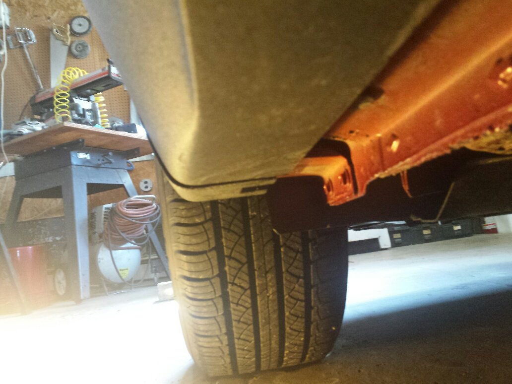

2017 SLE FORD EDGE Posted March 1, 2019 Report Share Posted March 1, 2019 Posted these pictures before, but wanted to let new people know of my issue with my edge. Anytime I wash vehicle, I have to open all 4 doors to wash bottom edges with garden hose before washing rest of vehicle. It comes from the ground the car is being driven on, with dirt & pieces of tiny gravel. This is my first new Ford & probably last-it's a poor design. If you have no knowledge of this and you keep car for years, how will that not rust out. Quote Link to comment Share on other sites More sharing options...

2017 SLE FORD EDGE Posted March 4, 2019 Author Report Share Posted March 4, 2019 Can someone tell me what the black clips are for? Quote Link to comment Share on other sites More sharing options...

2017 SLE FORD EDGE Posted March 5, 2019 Author Report Share Posted March 5, 2019 These are the SO CALLED mudflaps. Probably one reason for all the mud under door lip. Quote Link to comment Share on other sites More sharing options...

mike dexter Posted March 27, 2019 Report Share Posted March 27, 2019 On 3/4/2019 at 3:49 PM, 2017 SLE FORD EDGE said: Can someone tell me what the black clips are for? The paint shop at the assembly plant needs large holes for the doors to drain. At the same time, the holes want to be small in order to reduce the amount of road noise, wind noise, air leakage in the cabin. So Ford's solution is to install these black clips after the car is painted. I remove these from my cars. Leaving them in impedes water drainage from the door, which causes rust on that bottom edge. For me, they are not worth the 0.1% (or whatever) NVH improvement (doesn't everybody just turn on the radio anyways?) Plus, now I have some nice large access holes to spray in some WD40 into the door periodically, as an additional anti-corrosion measure. 1 Quote Link to comment Share on other sites More sharing options...
