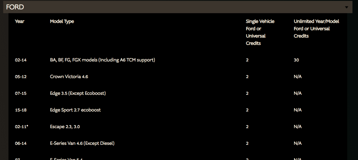

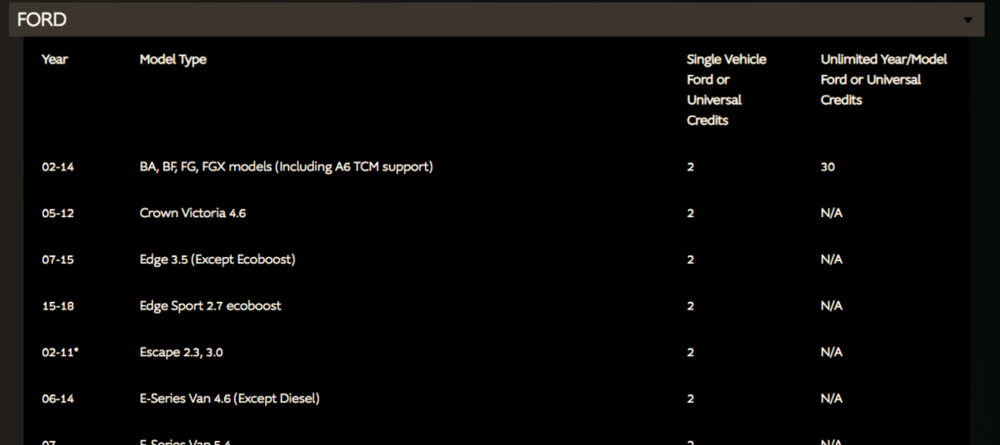

Nick Halstead Posted February 24, 2019 Report Share Posted February 24, 2019 2 minutes ago, Pharsyde6 said: Will be using HPTuners and a dyno to make my own tune ? When did they finally unlock it? From my understanding about a month ago, they had no desire to even offer the Edge 2.0, neither does SCT Quote Link to comment Share on other sites More sharing options...
Pharsyde6 Posted February 24, 2019 Author Report Share Posted February 24, 2019 1 minute ago, Nick Halstead said: When did they finally unlock it? From my understanding about a month ago, they had no desire to even offer the Edge 2.0, neither does SCT I will have to dig deeper into that. When I looked it up it was showing it was supported. If not I will have to find another program. Quote Link to comment Share on other sites More sharing options...

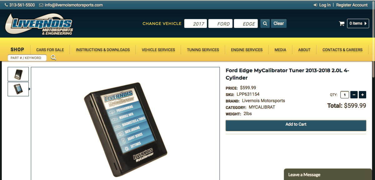

onyxbfly Posted February 24, 2019 Report Share Posted February 24, 2019 (edited) 6 hours ago, Pharsyde6 said: I will have to dig deeper into that. When I looked it up it was showing it was supported. If not I will have to find another program. According to the the HPTuner website, the 2.0 is not supported. You may have to call directly and see if it is supported. There is the possibility that their website is not up todate. https://www.hptuners.com/vehicles/ Nick is right, the only tuner at the moment to support the 2.0 is Livernois. https://www.livernoismotorsports.com/product/LPP631154 You can follow this thread for more info.... https://www.fordedgeforum.com/topic/24536-20-lms-e30-tune/#comment-187493 Edited February 24, 2019 by onyxbfly 1 Quote Link to comment Share on other sites More sharing options...
