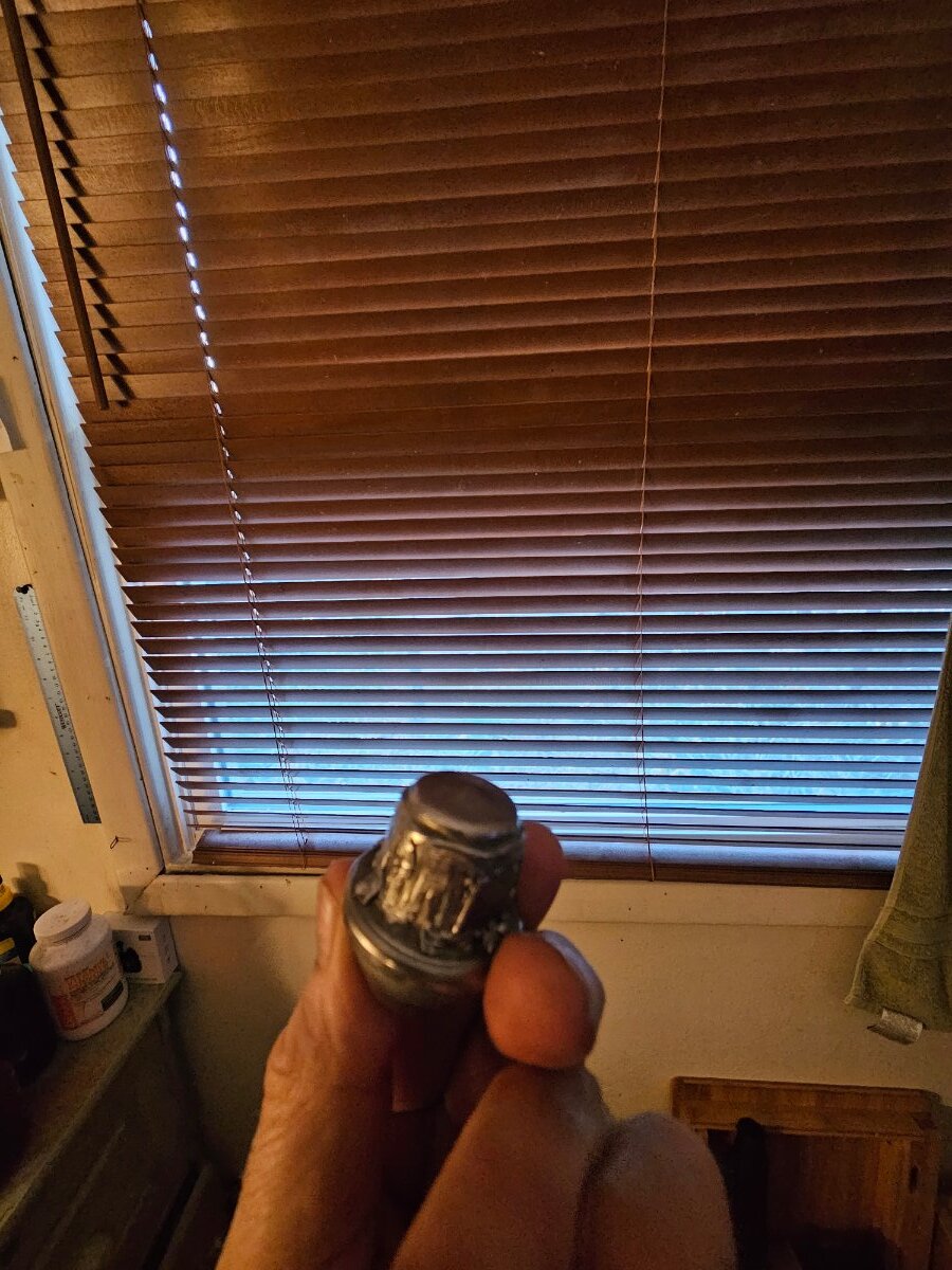

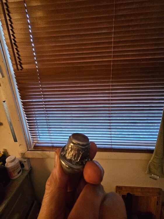

howdy Posted March 16, 2024 Report Share Posted March 16, 2024 1 Quote Link to comment Share on other sites More sharing options...
Tim W. AZ Posted March 20, 2024 Report Share Posted March 20, 2024 When I got new tires on my 2016, the shop wouldn't install the old lugs saying too many were too damaged. Now I have a 2020 and wondering if Ford has replaced the chrome cap style lugs. (I suppose I could walk out to the garage and look for myself, but I'm doing this right now.) Quote Link to comment Share on other sites More sharing options...
enigma-2 Posted March 20, 2024 Report Share Posted March 20, 2024 (edited) Tell your old shop to by pair of 14-1/4 & 15-1/2 mm sockets. Made to fit enlarged nuts. ~Enlarged nuts are a fact of life~ . Edited March 21, 2024 by enigma-2 Quote Link to comment Share on other sites More sharing options...
