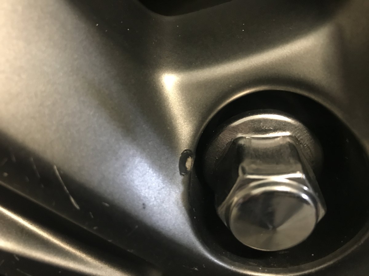

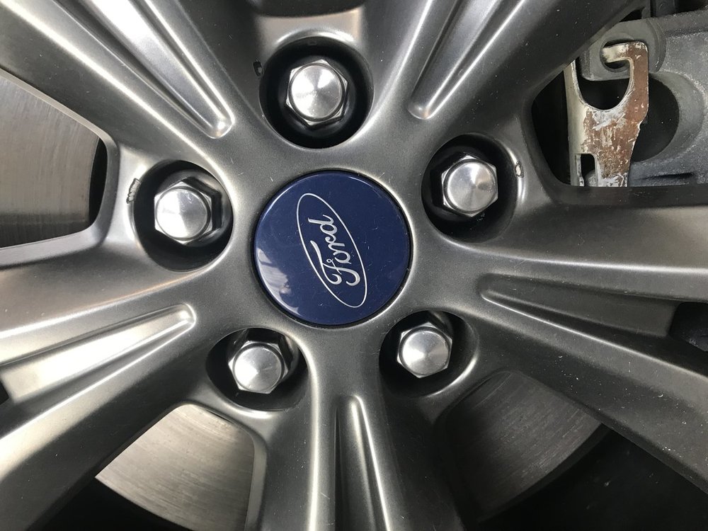

Today when I rotated wheels at home I found signs that the two-piece lug nuts were damaged by the use of an impact wrench, and the 21mm 6-point socket would not go on three of the lug nuts.
In addition almost every lug nut recess on my wheels has been chipped badly, obviously also due to the use of a high speed air impact tool.

The shinny outer shell is aluminum, and the dealerships use a pneumatic impact wrench to remove and install the lug nuts, which distorts and stretches the aluminum.
My dealership using this method also chipped my wheels - as the lug nuts come off the sockets swings around a hammers the wheels.
When I confronted the dealership about the swollen lug nuts and damage to my wheels, he responded that they use torque sticks - well that only helps not to over torque the nuts, the impact action still destroys the soft aluminum shell.
