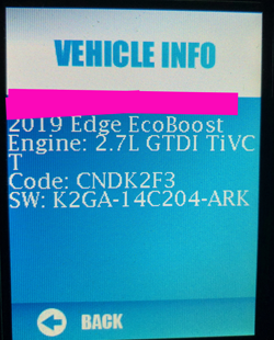

bobyellow Posted February 15, 2019 Author Report Share Posted February 15, 2019 (edited) Well, there appears to be something different in vehicle software. My new LMS Tuner shows the following (note: haven't applied a tune yet, was waiting for this transmission issue to be resolved). Code: Before : CNDK2F3 After TSB: CNDM1A4.H32 These are the Strategy codes I believe. SW: different too. Edited February 15, 2019 by bobyellow Images too large Quote Link to comment Share on other sites More sharing options...
jmr061 Posted February 15, 2019 Report Share Posted February 15, 2019 The dealer updated the PCM software. Not a surprise. Transmission learning is also reset when this happens. I would ask for the specific TSB #. I don't see one for updating the PCM. Ford may have told them just to update the PCM calibration/software or they figured they would try it on there own. Quote Link to comment Share on other sites More sharing options...
