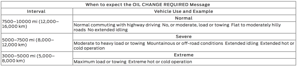

bobyellow Posted February 16, 2019 Report Share Posted February 16, 2019 Here is the recommended intervals. With a Tune, you might be outside of Normal driving? Although it you don't drive like the police are chasing you, still might be ok. If you hit the drag strip... 1 Quote Link to comment Share on other sites More sharing options...

WWWPerfA_ZN0W Posted February 18, 2019 Report Share Posted February 18, 2019 (edited) Ford has traditionally had two categories: normal and severe/special operating conditions. I see they added a third category (extreme), for 2019 (?). Anyway, you can look up Ford recommended intervals online at https://www.fleet.ford.com/partsandservice/maintenance-schedules/ ... Edited February 18, 2019 by WWWPerfA_ZN0W 2 Quote Link to comment Share on other sites More sharing options...

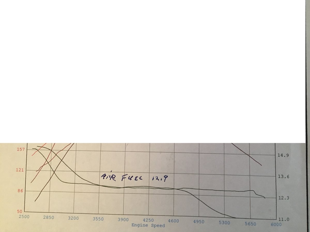

Xtra Posted March 14, 2019 Report Share Posted March 14, 2019 (edited) On 3/11/2019 at 5:06 PM, eddie368 said: . I spoke to jake at LMS and ask him if I would have any problem driving from Columbus OH to LMS after installing the therm,Intercooler and cold side pipe and cat back exhaust then drive it up there and get it dyno'd. He said should be OK............Ed I have all those mods on my car and when we did a pre tune dyno run everything was fine . It just had air fuel mix problems at high RPM . I would suggest staying below 4800RPM until you get that tune. As you can see the air fuel mix fell off fast around 4700 RPM . After the tune the air fuel mix was flat at 12.9 . Edited March 14, 2019 by Xtra 1 Quote Link to comment Share on other sites More sharing options...
eddie368 Posted March 15, 2019 Report Share Posted March 15, 2019 Yes I would say you are correct .I did about the same mods with my turbo subaru and after installing all the parts I had to drive about 60 miles.I just used a light foot on the gas . Kept it under 2700 rpm and little or no boost and no problems. Quote Link to comment Share on other sites More sharing options...
