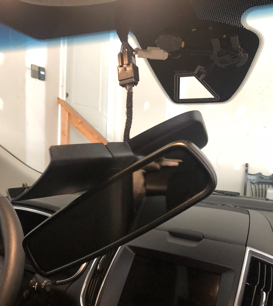

Zeus1 Posted February 2, 2019 Report Share Posted February 2, 2019 I can't seem to find any information on this. Google is just turning up rear view mirror repair for a basic (single post) mirror. I have a 2017 Edge Sport that had been sitting in cold weather (0' F) for 2 nights, I found the mirror/lane-sensing/high-beam camera assembly hanging as shown this morning. The vehicle only has ~1500 miles on it so safe to say I was surprised. It doesn't look like anything "broke", all plastic is intact and the integrity of the bracket seems fine. Any idea how to get this thing back on without taking it in to the dealer? Thanks. Quote Link to comment Share on other sites More sharing options...

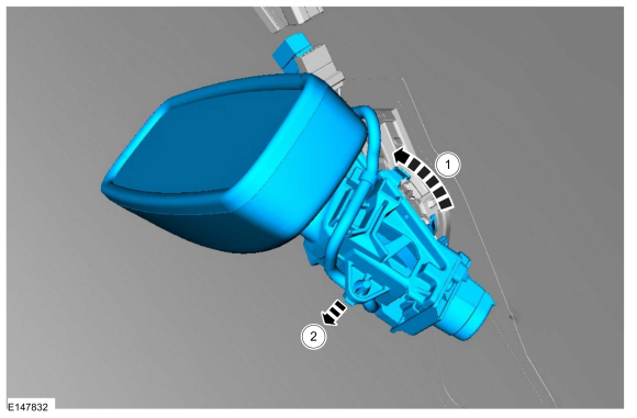

jmr061 Posted February 2, 2019 Report Share Posted February 2, 2019 (edited) Pic is taking it off....putting it on is reverse. You will need to take off the trim pieces and should disconnect the electrical connectors. Then put it all back on after the mirror is back in place. Edited February 2, 2019 by jmr061 1 Quote Link to comment Share on other sites More sharing options...
