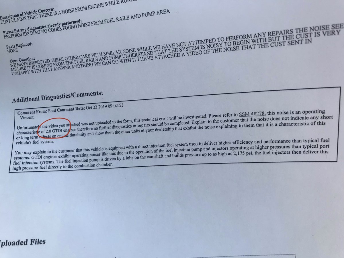

Edge2019SEL 2.0 EcoBoost Posted October 27, 2019 Report Share Posted October 27, 2019 They didn’t find anything to change or fix. Was told it’s the sound from the high pressure pump. I expressed clearly that it didn’t sound like this when I purchased it. They contacted the Main Technical Dept. Attached is what they came up with 1 Quote Link to comment Share on other sites More sharing options...
jamie1073 Posted October 27, 2019 Report Share Posted October 27, 2019 It is the injectors that click and tap and make all kinds of noise when running, you just notice it more at idle because it is slower and you are outside of the car. My V-6 sounds like a diesel in the morning before the idle settles down to the slower clickety clacking. Perfectly normal on a Direct Injected engine. Louder if you do not have the little plastic/foam engine cover installed or the hood pad, some engines no longer come with them. Even my mom's Lincoln MKC 2.3T does it, just quieter because it has the engine cover and underhood pad. Quote Link to comment Share on other sites More sharing options...

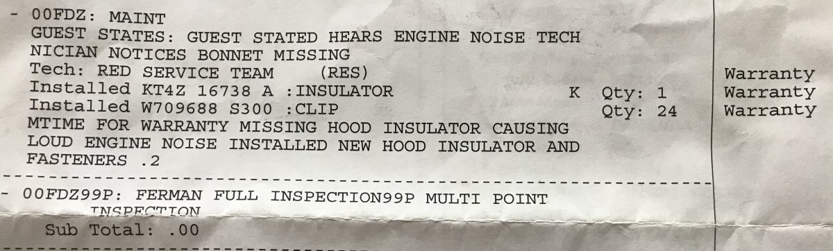

Edge2019SEL 2.0 EcoBoost Posted October 28, 2019 Report Share Posted October 28, 2019 Speaking of under hood cover/insulation ( aka bonnet). So I purchased my car in Paramus/NJ in March’19. It is a 2019 Edge 2.0 EcoBoost. Drove down to FL and this was the first time I mentioned the engine noise in a Ford dealership there. They popped the hood and the tech noticed I do not have the insulation attached to hood. They pulled a same type/year/model car from their lot. It had it. They replaced it under warranty. When recently I went back to the NJ dealership w the noise issue again, I mentioned the insulation. They also pulled same type/year/model car from their lot, it didn’t have it. But! I recently ran into someone purchased his same car in August from same dealership as I and he does have it!! ? So what now? Quote Link to comment Share on other sites More sharing options...
