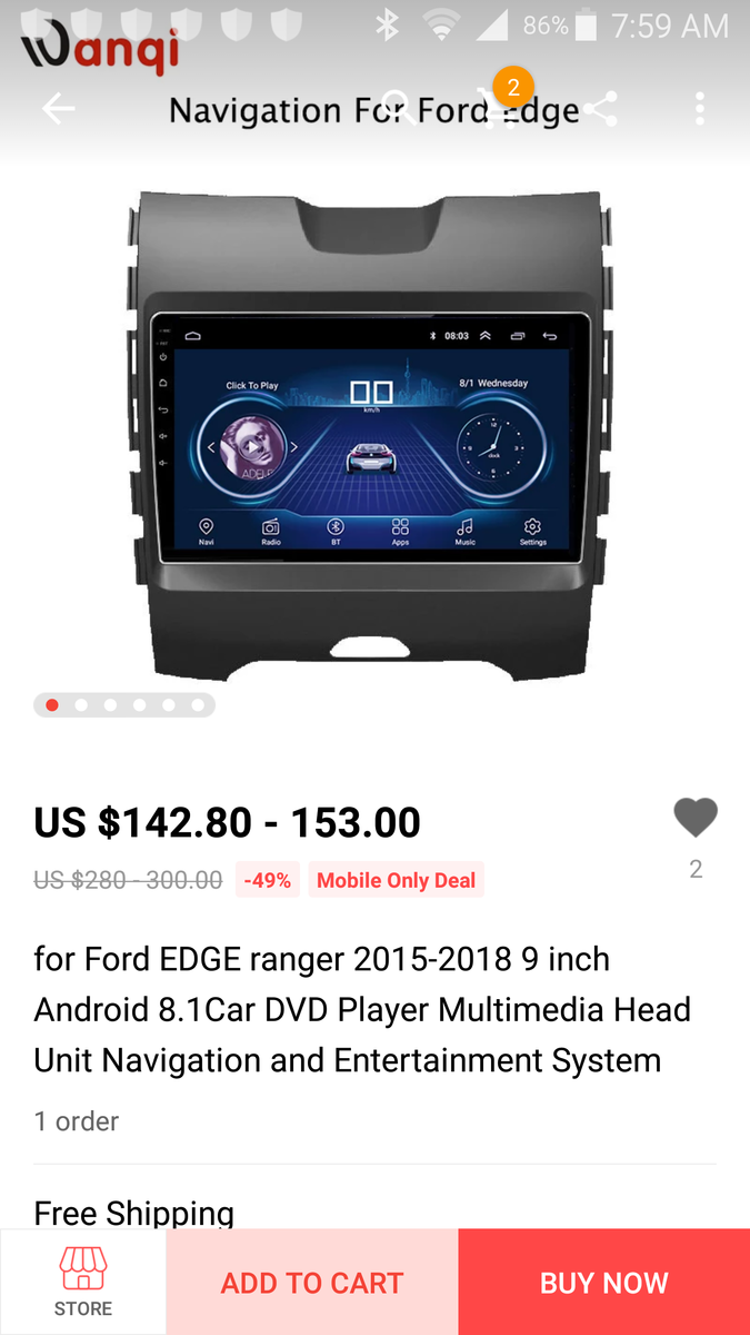

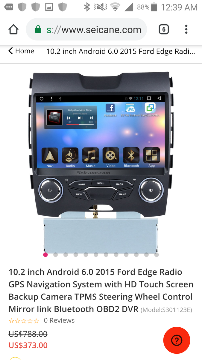

Dogg Posted March 9, 2019 Report Share Posted March 9, 2019 There are a lot of aftermarket AndroidHead Units our there (esp from China), which are plug and play (you may also need a Canbus adapter as well), and come complete with fitment bezel. Seicane.com offers a few, but there are more affordable options at Aliexpress. The picture attached is for the 2015 to 2017 Edge 1 Quote Link to comment Share on other sites More sharing options...
