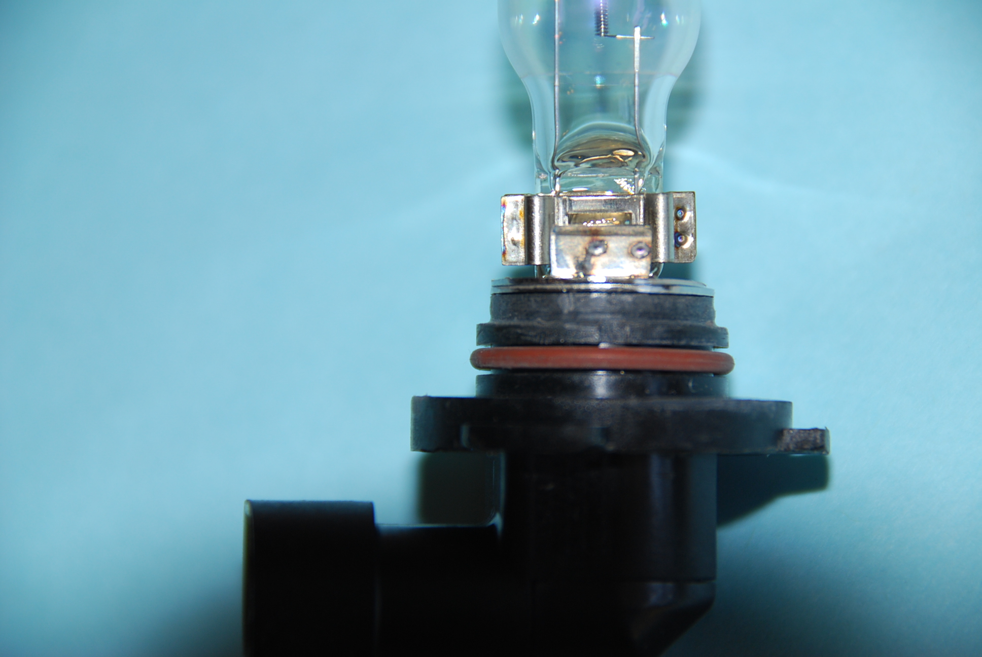

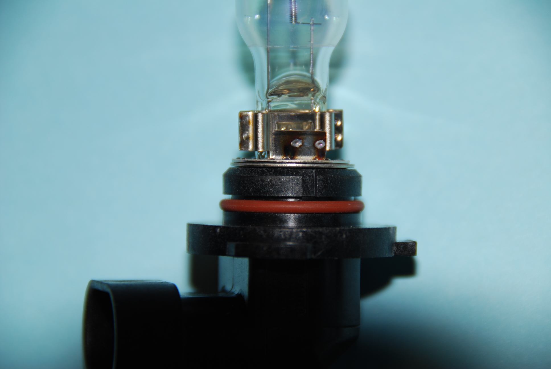

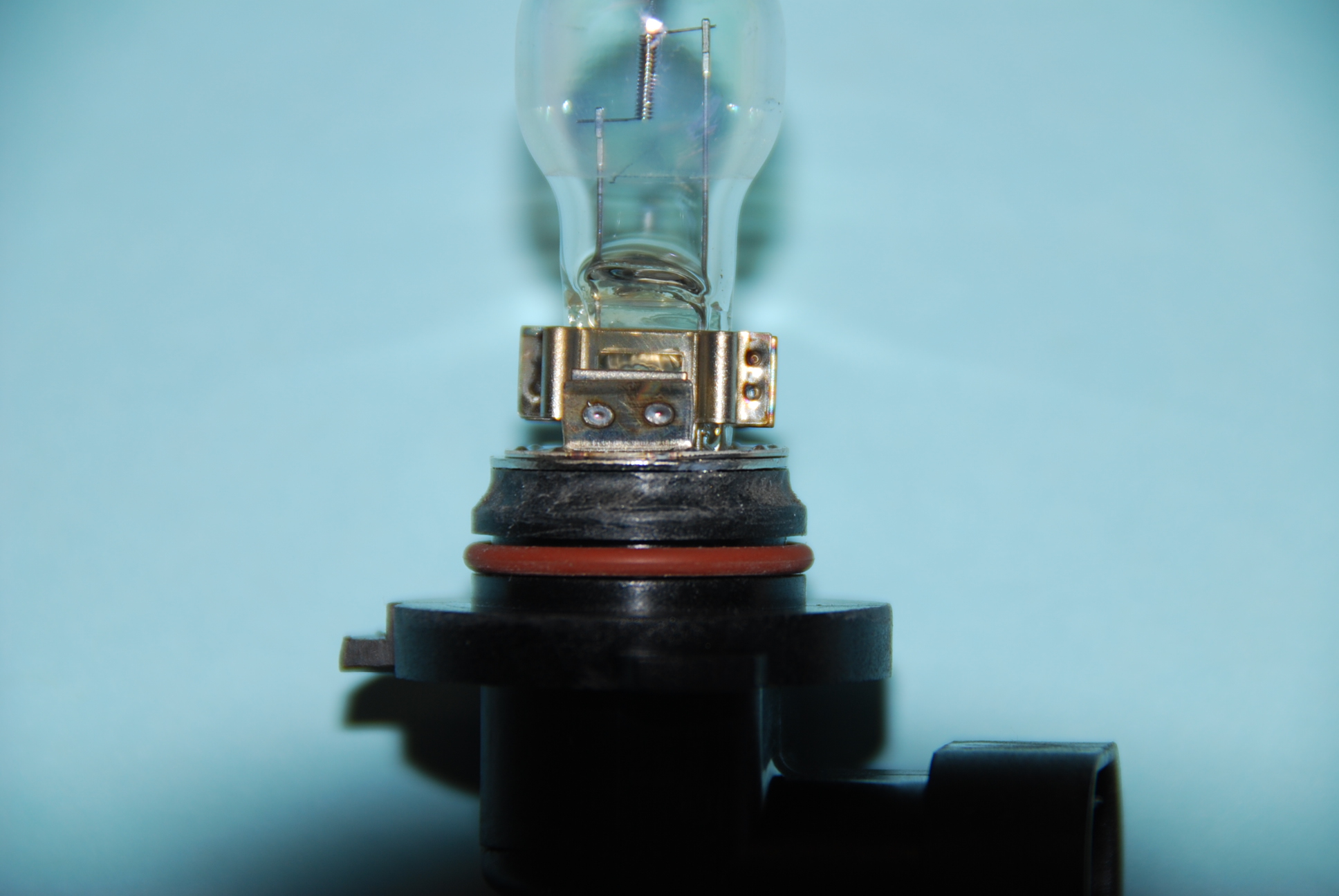

dadrett Posted April 2, 2009 Report Share Posted April 2, 2009 (edited) Kanatronic said: I have them on the high beams and they are incredible, the light extends almost the double fo the stock ones...They are very nice and the mod is minimal... Hey Kan (Kana?), Am in process of installing 9011s (HIR-1) high beams and H9s low beams. As sometimes happens, things are not as simple as U first hear. On 9011s did U experience so tight a fit that bulb wouldn't seat deep enuf to twist into place? I e-mailed Daniel Stern and he replied, "Casting flash on the inner diameter of the bulb hole. Wrap a piece of 100-grit sandpaper around your index finger, wet it, and go round and round and round and round with it in the high beam bulb hole to knock down the casting ridge. Use a piece of paper towel to wipe away the (wetted) dust, and the bulb should go right in." Did U do this? I'd prefer to remove headlight & point it to ceiling while I sand, but it looks as if headlight removal is not as simple as on F-150. :unsure: I think I'll start a thread "Headlight Removal?" Edited April 2, 2009 by dadrett Quote Link to comment Share on other sites More sharing options...

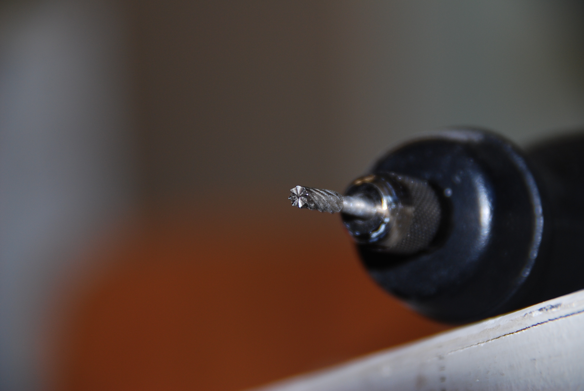

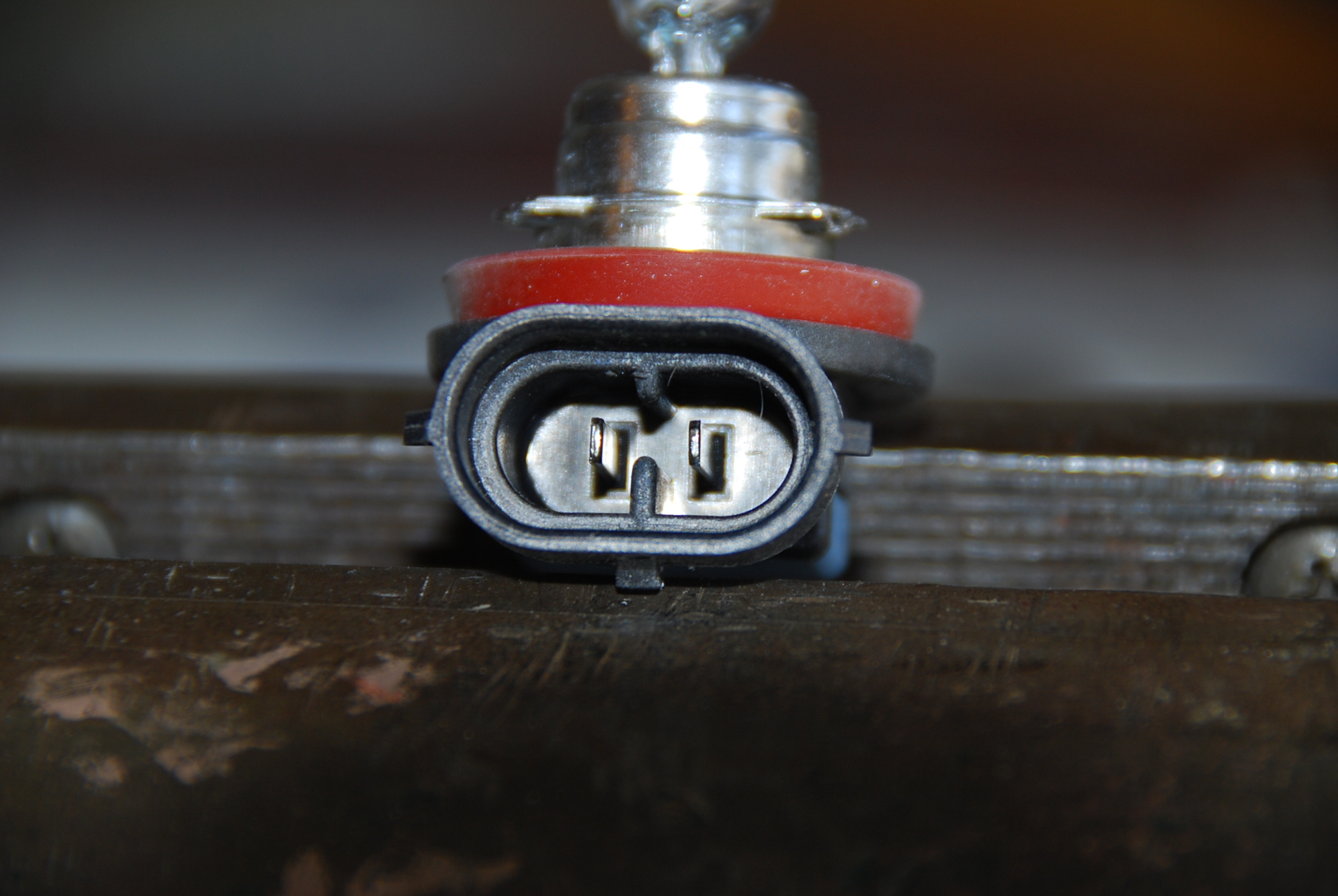

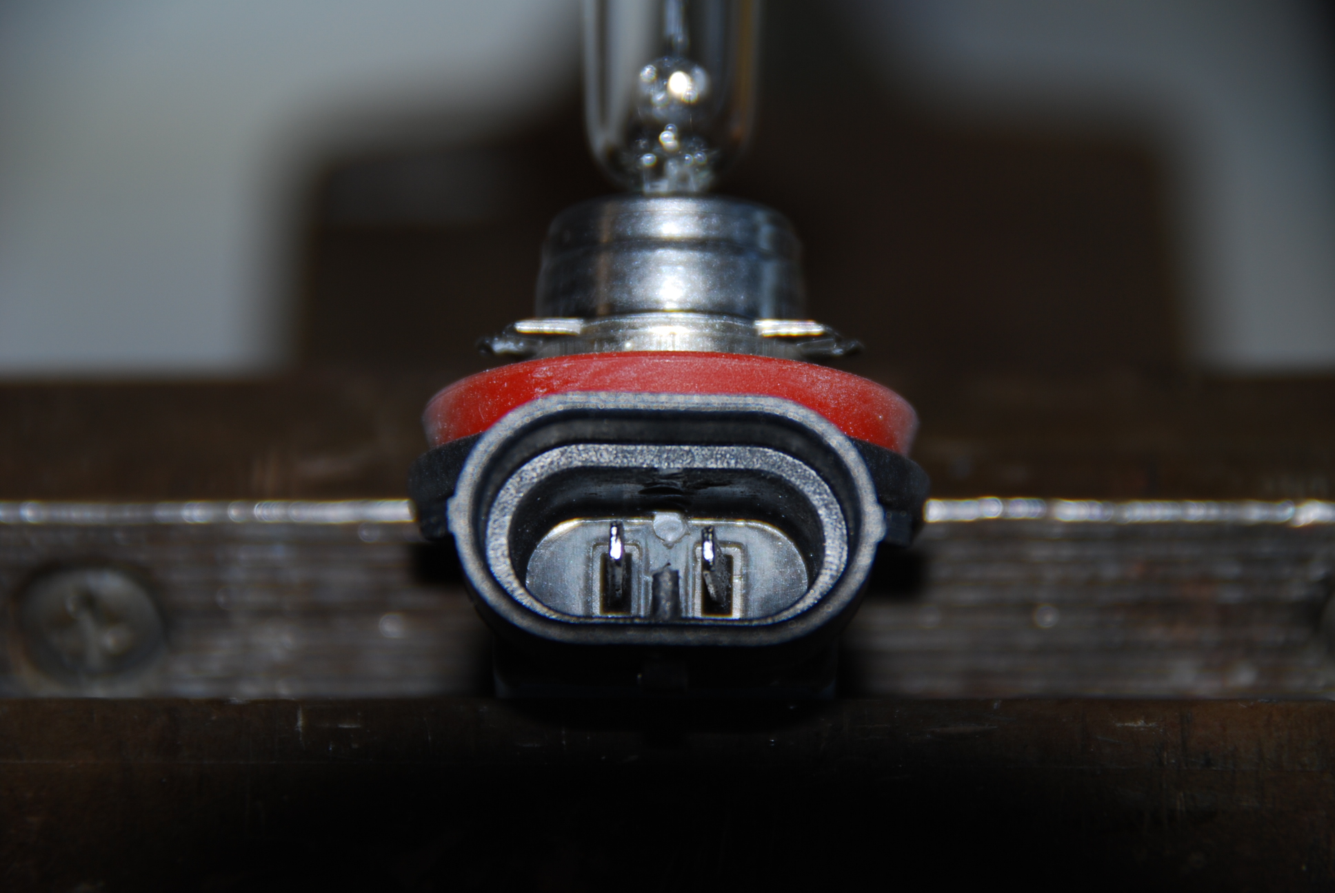

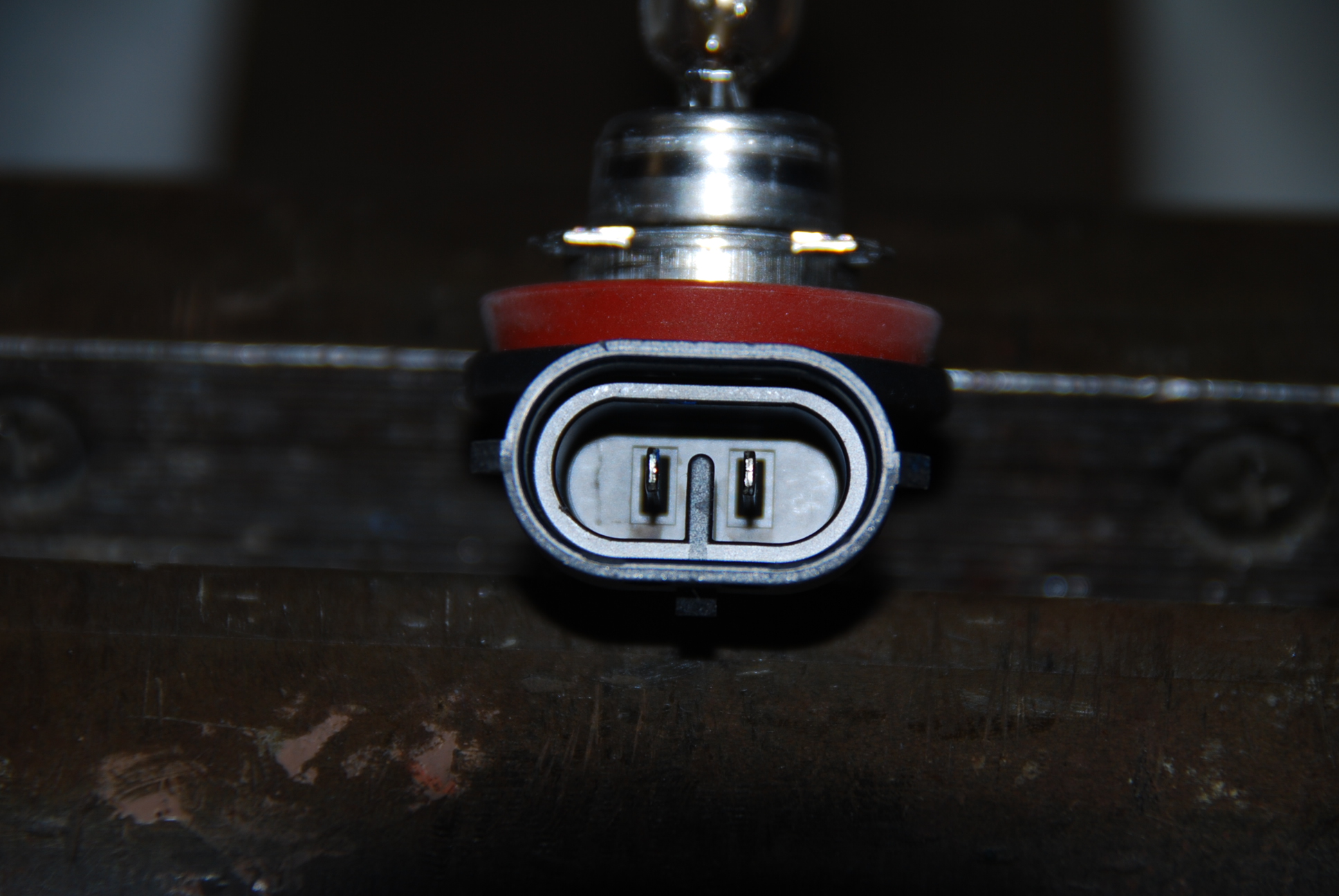

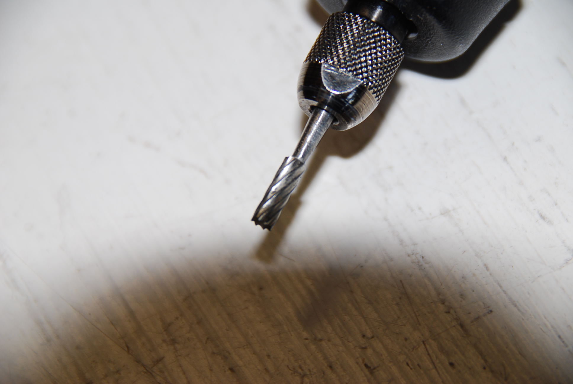

dadrett Posted April 2, 2009 Report Share Posted April 2, 2009 (edited) Jaak in TO said: The main top tab had to be trimmed a slight bit to fit ... I followed Daniel Strerns instructions. Hey Jaak, I take it U mean to remove shorter tab/key at top of socket between contacts. That was/is my plan. Will cut away that extra tab with rotary tool. (1) H11 w/key at bottom, (2) H9 w/two keys, (3) Bur (notice 8 cutting edges at end), (4) H9 w/upper key removed Another thing. There's a shield in front of the bulb. I checked w/magnet & it's not steel. I'm hoping it's aluminum & not plastic. Remember we're generating an 18.2% increase in wattage & I'm guessing that big an increase in heat. :unsure: If I understand correctly U've had U'rs installed a year w/no problems. Edited April 4, 2009 by dadrett Quote Link to comment Share on other sites More sharing options...
Orion Posted April 2, 2009 Report Share Posted April 2, 2009 dadrett said: I take it U mean to remove shorter "rib"/"key" at top of socket between contacts. That was/is my plan. Will grind away that extra tab with various rotary tool burrs &/or diamond points. It's much easier to just take short-head, flat-back wire cutters and snip that rib out...I had to do the same to fix a polarity issue on my HID's. Quote Link to comment Share on other sites More sharing options...
Kanatronic Posted April 3, 2009 Report Share Posted April 3, 2009 dadrett said: Hey Kan (Kana?),Am in process of installing 9011s (HIR-1) high beams and H9s low beams. As sometimes happens, things are not as simple as U first hear. On 9011s did U experience so tight a fit that bulb wouldn't seat deep enuf to twist into place? I e-mailed Daniel Stern and he replied, "Casting flash on the inner diameter of the bulb hole. Wrap a piece of 100-grit sandpaper around your index finger, wet it, and go round and round and round and round with it in the high beam bulb hole to knock down the casting ridge. Use a piece of paper towel to wipe away the (wetted) dust, and the bulb should go right in." Did U do this? I'd prefer to remove headlight & point it to ceiling while I sand, but it looks as if headlight removal is not as simple as on F-150. :unsure: I think I'll start a thread "Headlight Removal?" For the HIR-1 I had no problems at all, just cut a little bit the ears on the top as he suggested and period, I used a dremel, but you cna use anything, it is just plastic, in the low beans I still have the nightbreakers which is a direct replacement (which I will eventually replace if one of them get shot as they are pretty expensive) and also the H9 gives more light, but also is 65Watts, not 55W, as the origianl one, not sure if the wiring will be good enough to hold the extra 10 watts...but for now I will have the nightbreakers, for a while, I suggest not to do the sanding with the light assembly on, remove it and do it outside, if you decided to go that route, as the remainings of the sanding will go inside the headlight for sure, honestly if I have to sand something, I preffer to do it with the base of the bulb, not the otherway around... Quote Link to comment Share on other sites More sharing options...
dadrett Posted April 3, 2009 Report Share Posted April 3, 2009 (edited) Kanatronic said: For the HIR-1 I had no problems at all, just cut a little bit the ears on the top as he suggested and period . . . . . . . . . . . . . . . . . . . . . . . . . . . . . . . . . . . . . . . . . . . . . . . . . . . . . . . . . . . I preffer to do it with the base of the bulb, not the otherway around... Sounds as though U trimmed only ear at top, bulb pushed in easily & U were able to twist it into place. Excellent. I wasn't so lucky. I did NOT sand the hole in the reflector. Just as U prefer, I trimmed away part of bulb that wouldn't clear the opening. But it was more than sanding. I used bur shown below. The wiring appears to be same gage for both high & low beams. I was a little concerned with increased heat (about 18% more with 65 watt bulb), but I e-mailed Daniel Stern & he says it's not a problem (the shield is metallic unlike most of the rest of the headlight) and I'm sure Stern wouldn't put his stamp of approval on this swap if there was a problem with gage of wire. ^_^ (1) 9011 (HIR-1) notice chamfer just below metal flange, (2) same bur (just coincidence) as in post #66, but this time I use flutes on side, (3) bulb w/diameter reduced to fit into hole in reflector, (4) 2nd variation, cut with bur pointed at center of bulb A different approach: Around time I was "grinding" away, I e-mailed Stern: “Daniel, My original plan for seating the 9011 into reflector involved the three screws that hold round black piece that is headlight "tab ring." I think Ford doesn't want me messin' w/them because they're a pretty small security torx. So I'm guessing that backing out the screws to allow the ring to come away to allow the bulb tabs to slid behind the "ring tabs" is out.” His reply: “But that's exactly what to do in the case you describe. Happens occasionally on some Range Rovers, too.” So, it turns out that screws in question are T15 torz, but U can’t tell size by using regular torz because they don’t have “security hole.” Harbor Freight had a 100-piece security bit set on sale for $4.99. Heck, U can’t buy a set of jewelers’ screwdrivers for that. Just remember, it’s HF, but as often as U’d use them, U’d be foolish to buy better quality. HF is great, but U have to know what U’r buying :yup: & how their stuff will hold up to U’r usage. Edited April 22, 2009 by dadrett Quote Link to comment Share on other sites More sharing options...
