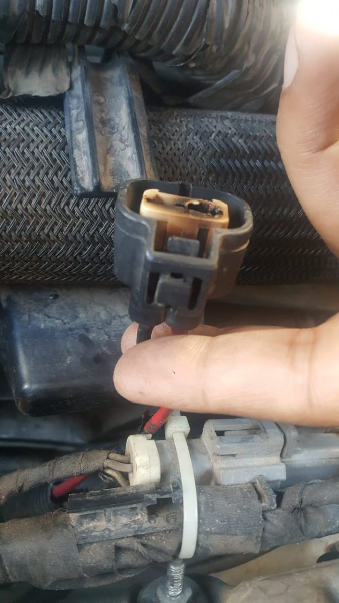

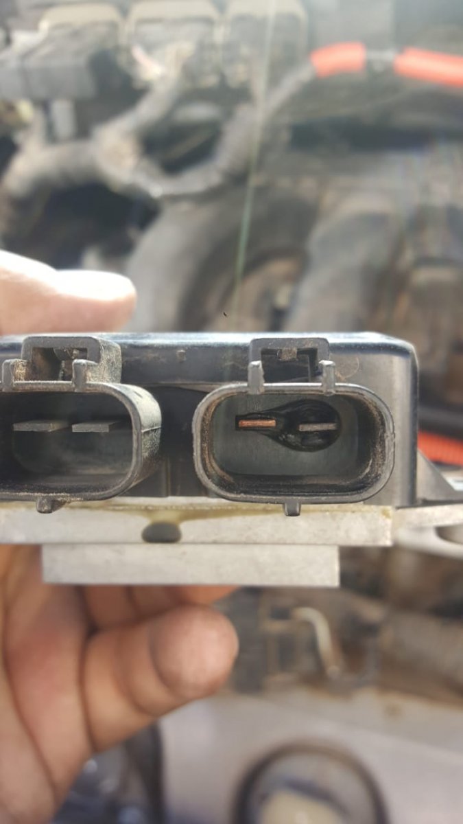

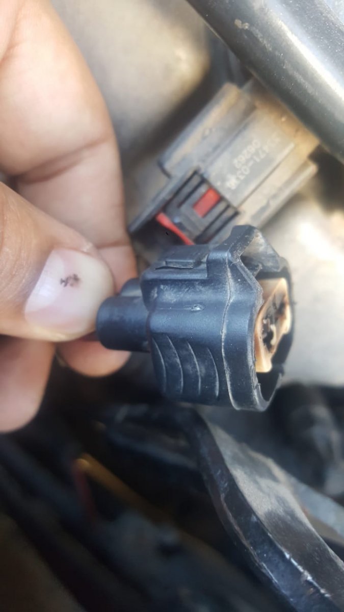

jesus_lomor Posted December 28, 2018 Report Share Posted December 28, 2018 Hi all, I am looking for this cooling fan connector (Not the module) but I couldn't see any part number on it. Does anyone knows how to find it? I have asked in some stores, but they all say that I have to buy the complete cooling fan assembly, and I really don't want to do that. I gess this happened because of a loose terminal. Thanks in advance! Quote Link to comment Share on other sites More sharing options...

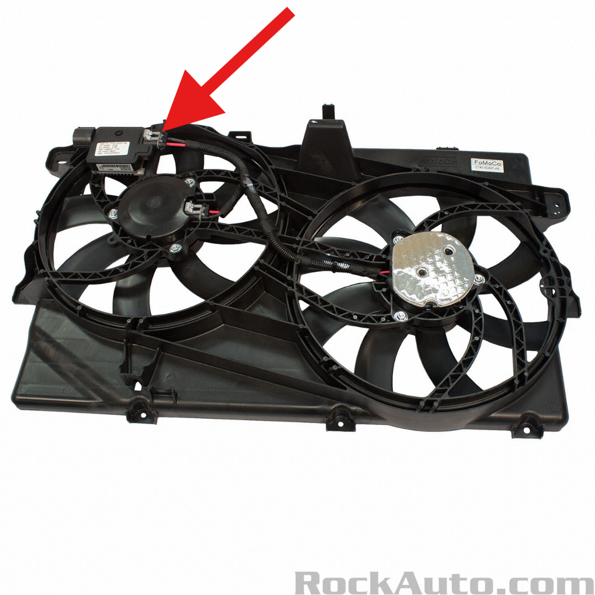

WWWPerfA_ZN0W Posted December 29, 2018 Report Share Posted December 29, 2018 Ford should have this available in their catalog, I would think. RockAuto.com is showing a radiator fan relay connector (and also a motor connector): https://www.rockauto.com/en/catalog/ford,2007,edge,3.5l+v6,1434490,electrical-connector,radiator+fan+relay+connector,18946 but it is not the right part. 1 Quote Link to comment Share on other sites More sharing options...
jesus_lomor Posted December 29, 2018 Author Report Share Posted December 29, 2018 8 hours ago, WWWPerfA_ZN0W said: Ford should have this available in their catalog, I would think. RockAuto.com is showing a radiator fan relay connector (and also a motor connector): https://www.rockauto.com/en/catalog/ford,2007,edge,3.5l+v6,1434490,electrical-connector,radiator+fan+relay+connector,18946 but it is not the right part. Thanks man, I took a look on the web page but unfortunately couldn't find it. I'll keep digging. But, thanks for the link, it has really nice information. Quote Link to comment Share on other sites More sharing options...
GM1 Posted August 28, 2019 Report Share Posted August 28, 2019 Hi, I have the exact same thing, my connector from the relay to the fan looks like this (see picture), How did you fix it? Thanks Quote Link to comment Share on other sites More sharing options...
handfiler Posted August 28, 2019 Report Share Posted August 28, 2019 This is a common issue on a lot of Fords. The fan has a high current draw when it is in good shape and it gets worse when the fan gets older. The plugs are typically the first area to experience a conductive loss and that results in higher resistance which causes the meltdown. Make sure the replacement connections are clean and tight when you replace them. It would also be a good idea to check the current draw of the fan once the connection is repaired to make sure it isn't exceeding the fuse/wiring ratings. Quote Link to comment Share on other sites More sharing options...
