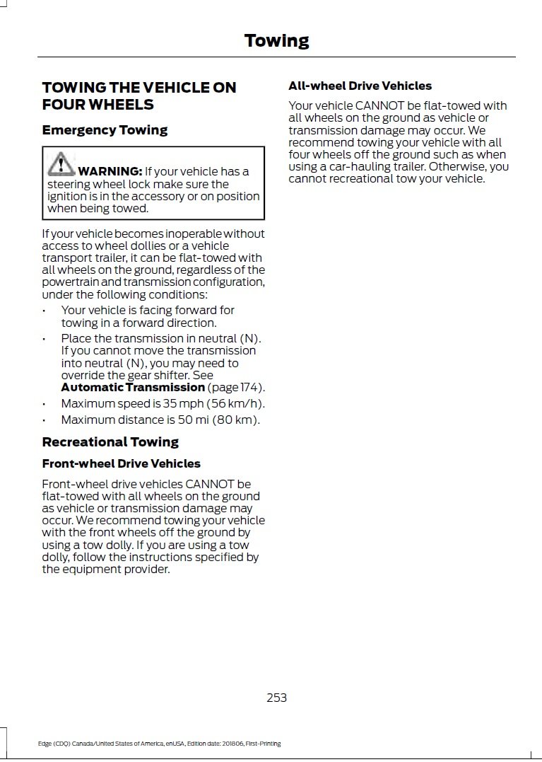

Sledder Posted December 23, 2018 Report Share Posted December 23, 2018 (edited) This really got my attention because my owners manual and the one I downloaded from the Ford webpage say the complete opposite, do not recreational flat tow. Not wanting to be too cantankerous in my first post I did a little research. It turns out that the owners manuals on the Ford website are in conflict. The HTML version says you can recreational flat tow and the PDF version says you cannot. The page provided by Omar above is from the HTML version of the owners manual. Here is the page from the PDF version. (page 253) http://www.fordservicecontent.com/Ford_Content/Catalog/owner_information/2019-Ford-Edge-Owners-Manual-version-1_om_EN-US_07_2018.pdf I don’t know if you can flat tow or not but I guess I would take both pages to the dealer and them what’s up. Here is a link to the Ford page with both versions of the owners manual. https://owner.ford.com/tools/account/how-tos/owner-manuals-search-results.html?type=ymm&year=2019&make=Ford&model=Edge Edited December 23, 2018 by Sledder clarification Quote Link to comment Share on other sites More sharing options...
omar302 Posted December 23, 2018 Report Share Posted December 23, 2018 My first guess would be that the PDF would be a 1st print while the html version is the always the latest, in the PDF version there is no difference between both drivetrains (2.0 or 2.7) while the html version does. Anyway, found the Ford Towing guide and it says the same thing as the html version, the 2.0L 4 cyl cannot be towed on 4 wheels while the 2.7L V6 AWD can. Quote Link to comment Share on other sites More sharing options...
