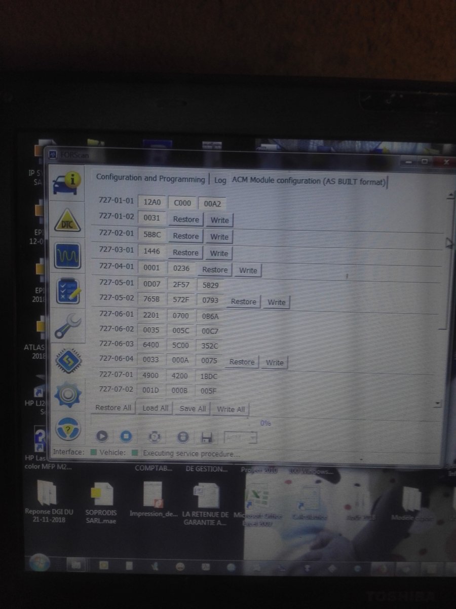

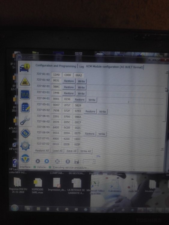

Inno Posted December 17, 2018 Author Report Share Posted December 17, 2018 Thanks dear. I found the path. Now the issue is that I have been asked to confirm my Sync version, which I currently don't know. I googled it but can't find. Do you have an idea of how to check it? Note that I am outside US. Am in West Africa. Also the group of number is 3 in my interface instead of 4 from yours. Is the right parameter in my side? Pls see the attachment. Thanks! Quote Link to comment Share on other sites More sharing options...
omar302 Posted December 17, 2018 Report Share Posted December 17, 2018 You have Sync 2. For 727-04-01, you will need to change the "0001" to "0101". Quote Link to comment Share on other sites More sharing options...

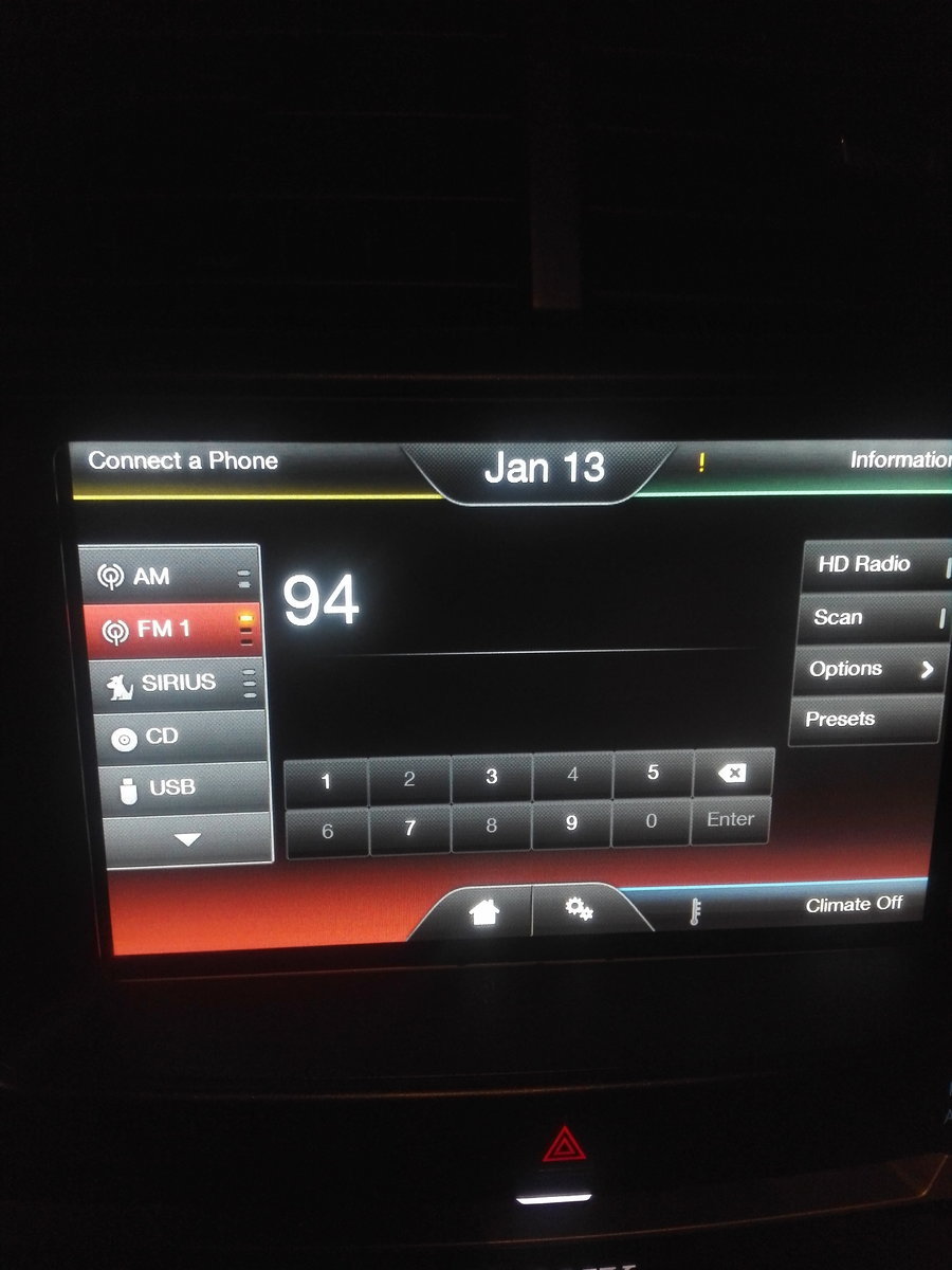

Inno Posted January 13, 2019 Author Report Share Posted January 13, 2019 On 12/17/2018 at 7:20 PM, omar302 said: You have Sync 2. For 727-04-01, you will need to change the "0001" to "0101". Hi, I have changed to "0101. By scan I can get the pair number frequency but I cannot direct tune to them. For example to 94.4 Quote Link to comment Share on other sites More sharing options...
omar302 Posted January 14, 2019 Report Share Posted January 14, 2019 I found this also, not sure if it will help as I don't really know this issue: Tuner Region 727-02-01 x*xx xxxx xxzz 0=NA (North America), 1=GCC, 2=Japan, 3=Europe, 4=Asia Pacific Quote Link to comment Share on other sites More sharing options...
Inno Posted January 14, 2019 Author Report Share Posted January 14, 2019 Thanks! I'll try 0301, Europe version as we are close to Europe. Quote Link to comment Share on other sites More sharing options...
omar302 Posted January 18, 2019 Report Share Posted January 18, 2019 OK, today I found out how to solve it, you have to change the country for the APIM. With US you cannot manually put odd frequency like in your screenshot. With Qatar country code (mine) it works for all frequencies. ForScan has a setting directly for country code. Or you can change the code like this: 7D0-02-01 **** xxxx xxxx ****: 5553=U.S ****: 5141=Qatar Quote Link to comment Share on other sites More sharing options...
