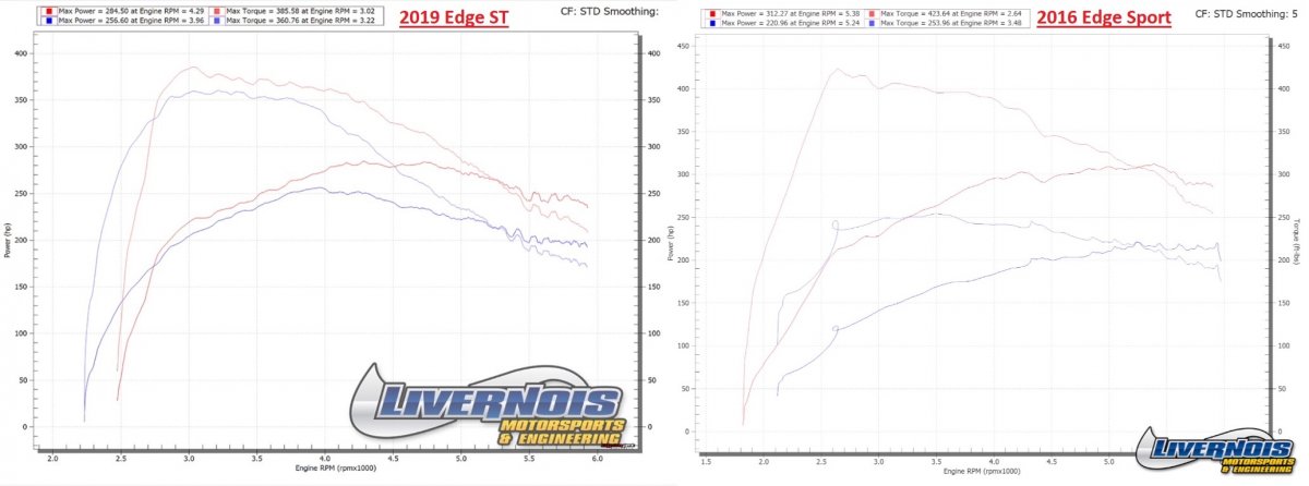

omar302 Posted November 30, 2018 Report Share Posted November 30, 2018 So I looked at the 2016 Edge Sport Livernois Tune from this video and from screenshots of the HP & TQ graphs I put them side to side for easy comparison. For now, it seems the Sport is better tuned: 1 Quote Link to comment Share on other sites More sharing options...
handfiler Posted November 30, 2018 Report Share Posted November 30, 2018 The ST runs out of steam rather quickly. No point flogging it past 4,500 rpm. The Sport at least makes power to close to 5,500. You don't see loops on a dyno graph very often. Maybe some slippage when the turbos spooled up. Quote Link to comment Share on other sites More sharing options...

Perblue Posted November 30, 2018 Report Share Posted November 30, 2018 Does make you wonder what the did do then besides a tune since the graphs are different. Smaller turbos? Quote Link to comment Share on other sites More sharing options...

eddie368 Posted November 30, 2018 Report Share Posted November 30, 2018 After looking at the dyno charts something does not make sense! Based to the numbers on each chart the 2016 peaked at 91+ hp and 171+ lbs TQ.While the ST only gained 27+hp and 24+lbs tq.Even if you take into account that the ST came from the factory with 20 more hp and 30 more lbs tq (the factory gain was probably gained by tuning)the 2016 gained 44 more hp and 117 lbs tq than the ST after both had been tuned. Other factors can come into play but 117 lbs of tq. No Way! Quote Link to comment Share on other sites More sharing options...
blitz118 Posted November 30, 2018 Report Share Posted November 30, 2018 2 hours ago, eddie368 said: After looking at the dyno charts something does not make sense! Based to the numbers on each chart the 2016 peaked at 91+ hp and 171+ lbs TQ.While the ST only gained 27+hp and 24+lbs tq.Even if you take into account that the ST came from the factory with 20 more hp and 30 more lbs tq (the factory gain was probably gained by tuning)the 2016 gained 44 more hp and 117 lbs tq than the ST after both had been tuned. Other factors can come into play but 117 lbs of tq. No Way! I have to agree with you, and something is not right with the 2016 dyno graph. How can it pick so much horsepower and torque with just a tune? Those numbers are not realistic. Quote Link to comment Share on other sites More sharing options...
Rimcrim Posted November 30, 2018 Report Share Posted November 30, 2018 They also stated on their YouTube page that this is just their first attempt: "And this is just version 1. As with all of our timing things will get better with time as well!" I think that 2016 tune graph was not to a stock car, and was definitely not using the first tune available for the car. Quote Link to comment Share on other sites More sharing options...
MrHappy Posted November 30, 2018 Report Share Posted November 30, 2018 My hunch is they turbo'd (or twin turbo'd) the sport then tuned and compared to a stock, non turbo sport. Quote Link to comment Share on other sites More sharing options...

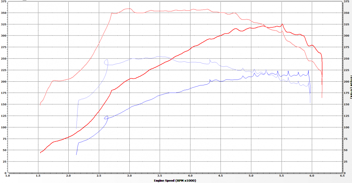

bmwta Posted November 30, 2018 Report Share Posted November 30, 2018 11 hours ago, omar302 said: So I looked at the 2016 Edge Sport Livernois Tune from this video and from screenshots of the HP & TQ graphs I put them side to side for easy comparison. For now, it seems the Sport is better tuned: The 2015-2018 Edge Sport dyno graph on their website shows a different version with less outputs. Draw your own conclusions... Quote Link to comment Share on other sites More sharing options...

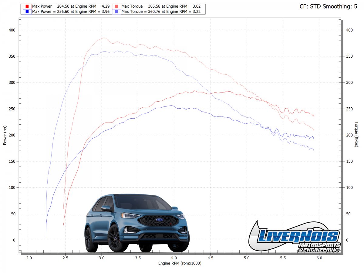

Rimcrim Posted November 30, 2018 Report Share Posted November 30, 2018 (edited) For Reference, here are the two graphs that are provided on the product page of their website Edge Sport Edge ST Edited November 30, 2018 by Rimcrim Quote Link to comment Share on other sites More sharing options...
