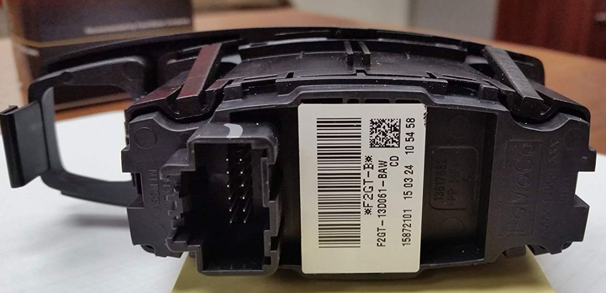

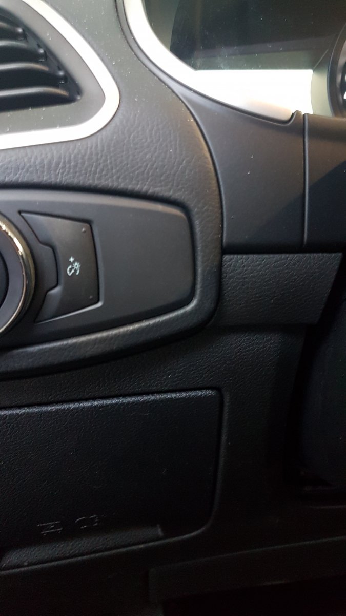

so this is my first post.  I want to install my old 20some inches LED on my Edge SEL 2018.  finding a location for the switch is quite a project since I want it to look as much as possible OEM.  I installed the LED bar on a License Plate Mount I prior purchased on Amazon for 40 some dollars.   now, I need to install the switch.  I had 3 options but rapidly discarded the setup in the center console since it's too much work to make it look good.
Now, I have the options of either on the fuse panel with a quick disconnect on the back or next to the light switch.  on the fuse panel, it's easy and can be done quickly but my first option would be next to the switch panel.
anyone can tll me how to remove the switch panel ?  i felt a clip on the right side of it but I cannot find one on the other side.
sorry for the pic, i can only upload 1 pic at the time per post
 so i chose the one with the location next to the light switch!
thanks for your help!

i finally decided to put the switch on the fuse panel for now.  put a quick disconect in case i needed to remove the panel later.
https://ibb.co/z8gpTWs
https://ibb.co/D89GwQM
https://ibb.co/s3MPqGC
https://ibb.co/mBvkh5S
https://ibb.co/qrfR4MX
https://ibb.co/JKX63pd
https://ibb.co/yPZ3HnJ
https://ibb.co/YTp849b
here's some picture of the switch.  not sure if the links work tho, first time in a long time i use that kind of service
Edited by p7363
added 2 links for the light bar itself
